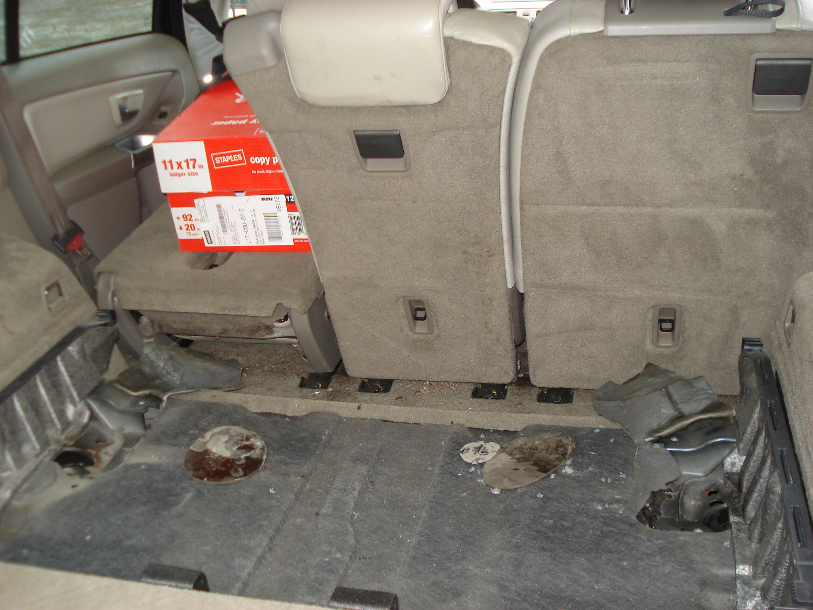

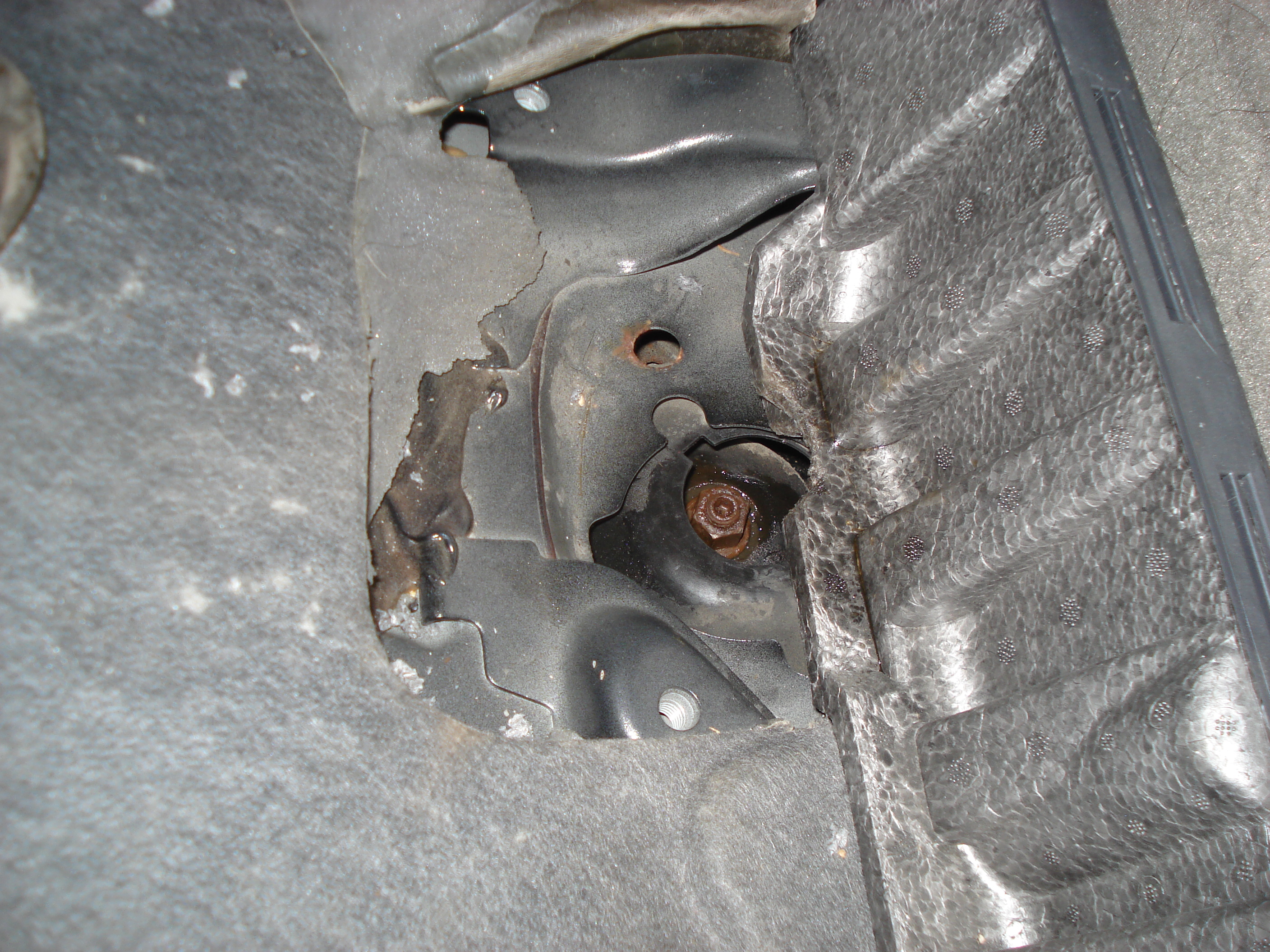

This past weekend I took some time while at my parent's place for Christmas to install the rear shocks on our XC90. For anyone interested, this is how I got to the top nuts on the shocks, note ours is a 5-seat version without the 3rd row of seats:
- Remove larger of two cargo covers behind rear seat
- Remove Cargo Tray from car
- Note where there is a line in the insulation and cut around this with a utility knife (there is probably a way of getting to this without cutting. I don't have that much paitence, especially if it's below freezing outside).
- Remove hard rubber insulation (glued to body)
- Remove plastic cap in body by rotating counter-clockwise
Now you have access to the top bolts.
Reference Pictures:

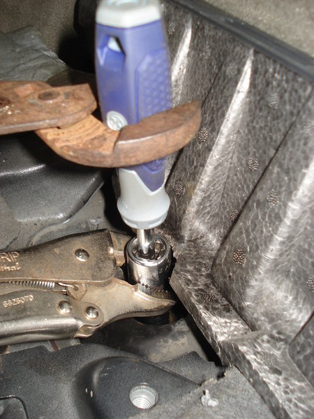

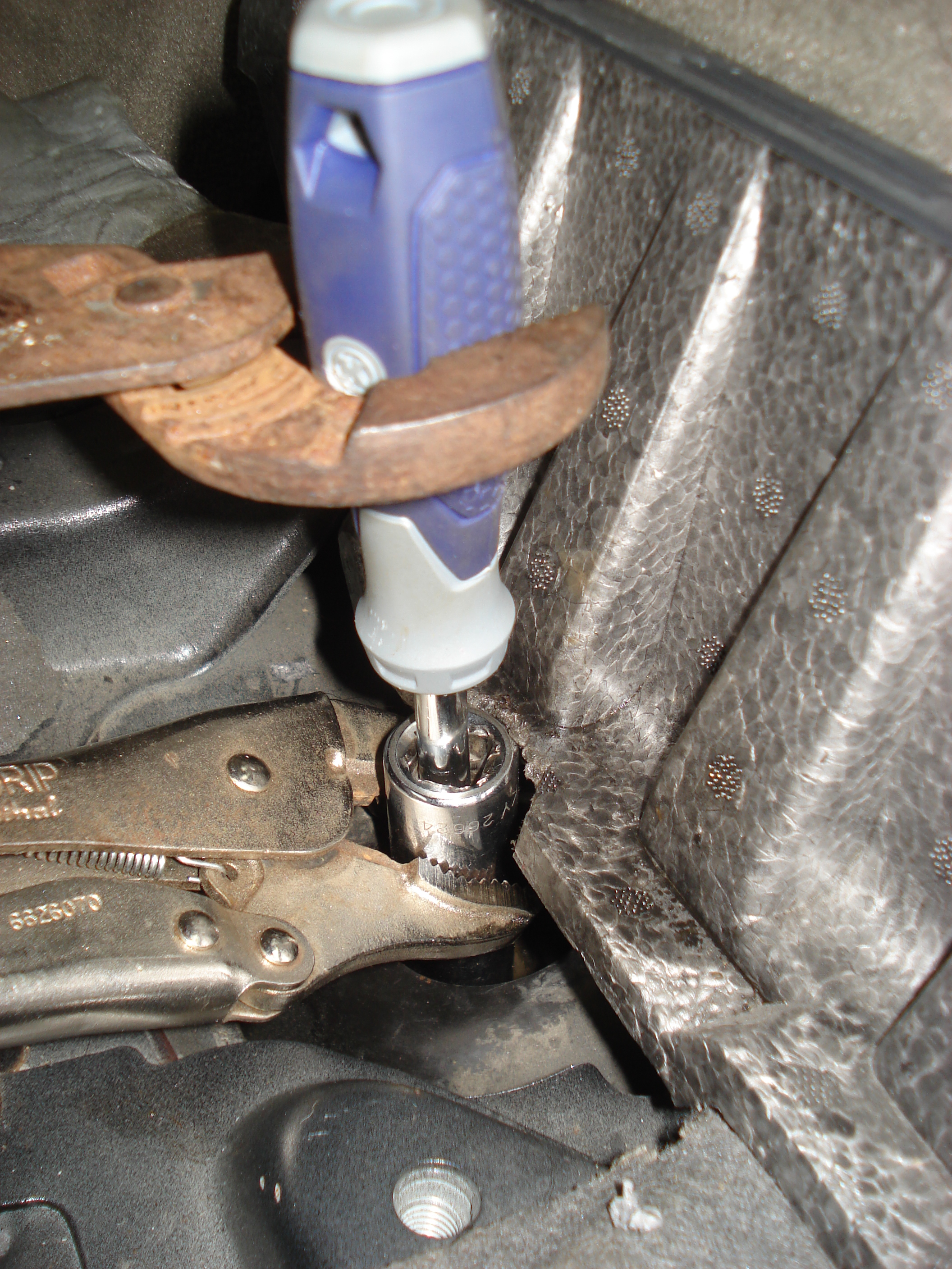

The install wasn't terrible, but I had some issues getting the old rear shocks out. The top bolts/nuts were a little rusted and even though I was generous with the PB Blaster for a few days leading up to the install, they wouldn't come off easily with my 1/2" impact gun. I ended up having to rig up a tool which included:
-A multi-bit screwdriver with an allen-wrench bit
-Channel Locks
-Vise Grips
-18MM socket.
here's a Picture:

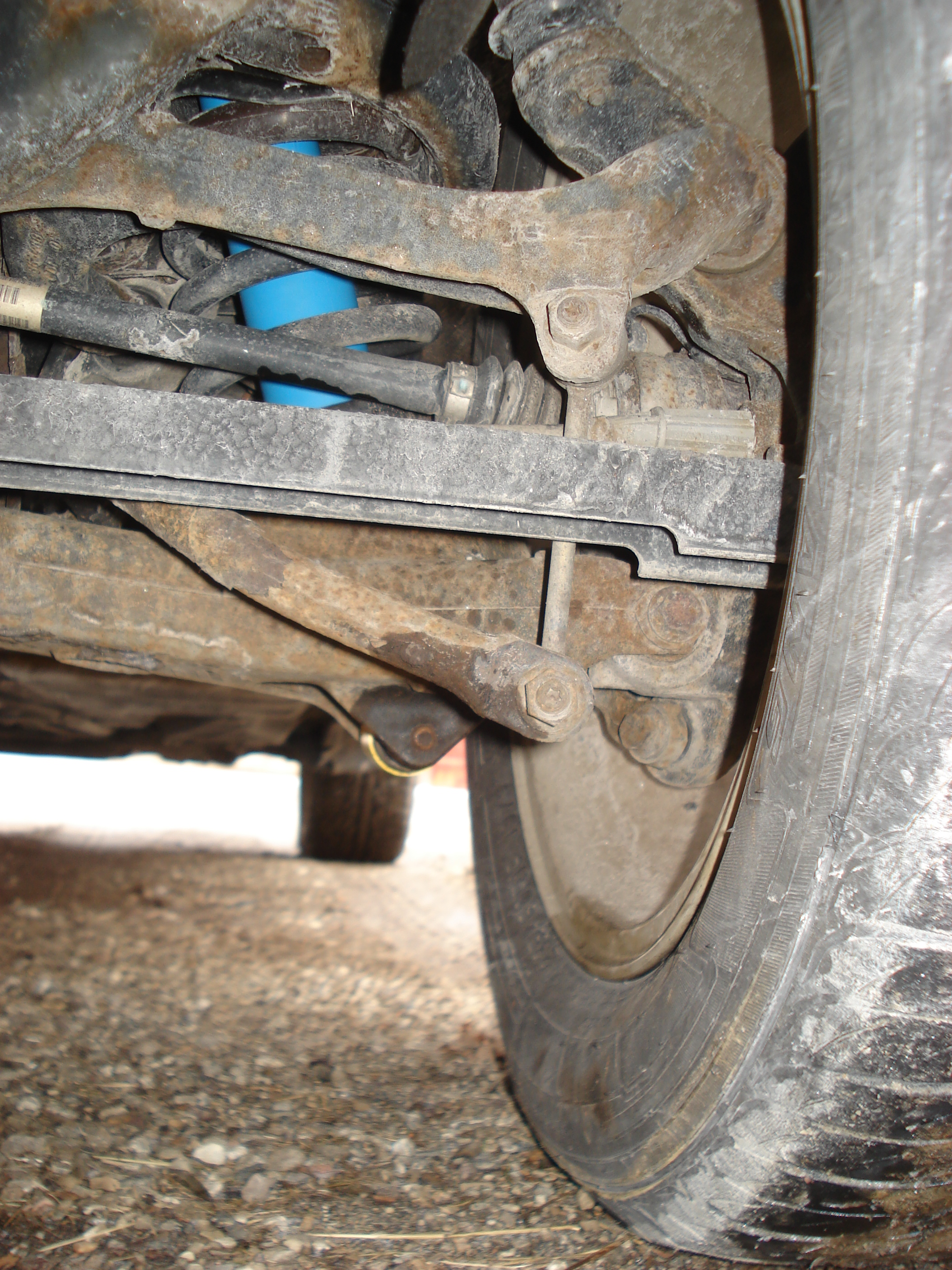

XVTer, thanks so much for these great posts! Wondering if when you replaced the rear shocks you had to unload the rear springs as well. Is this a stupid question? Are there standard springs on the rear? I do a lot of work on my car but honestly have not noticed the rear springs, as I'm sitting at work right now.
Thanks again!
Thanks again!
XVTer
- Posts: 27
- Joined: 24 Jun 2010, 13:34
- Year and Model: XC90 T6, 2004
- Location: Newburyport, MA - USA
I didn't unload the rear springs, though it would probably be easier to re-install the shocks if I had. I simply had the rear tires up on jack stands and after reinstalling the top of the new shocks, went underneath with a wood block on my jack and jacked up the shock until I could get the bottom bolt through. It was the easiest way I could think to do it. Having it up on the jack stands allowed me to slip the shock up through the bottom of the rear springs pretty easily.

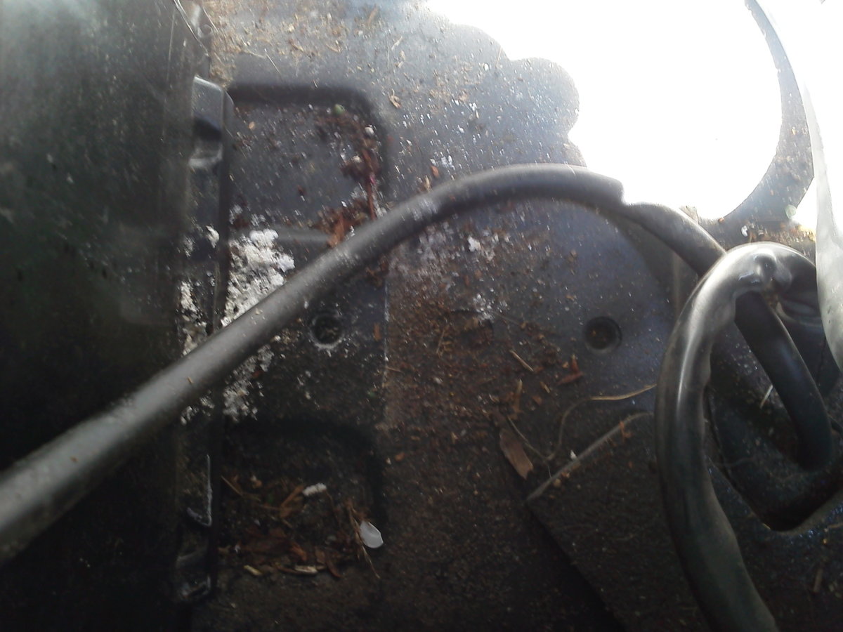

Hope that makes sense. Here is a photo from underneath with the car back on the ground for your reference.

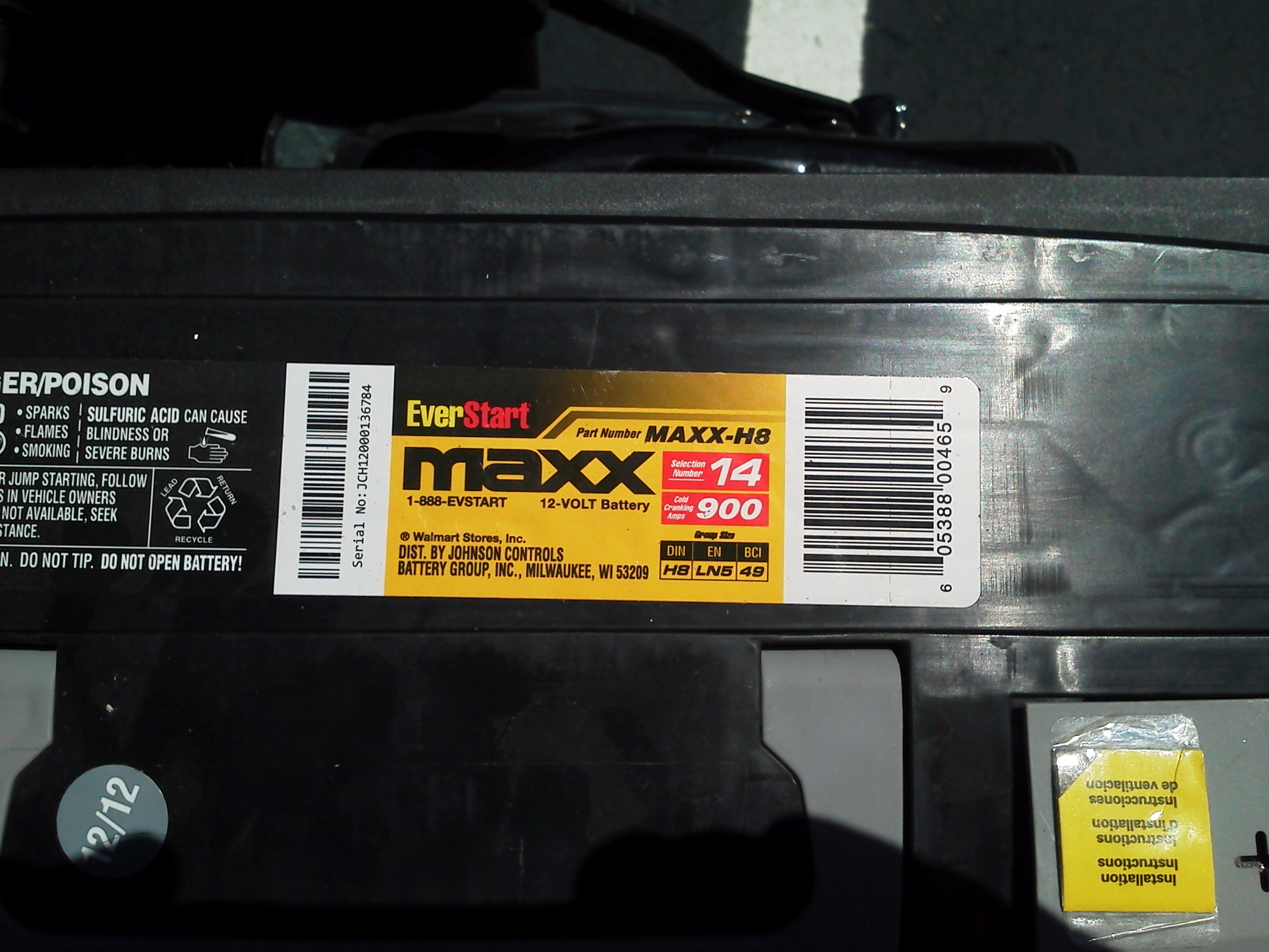

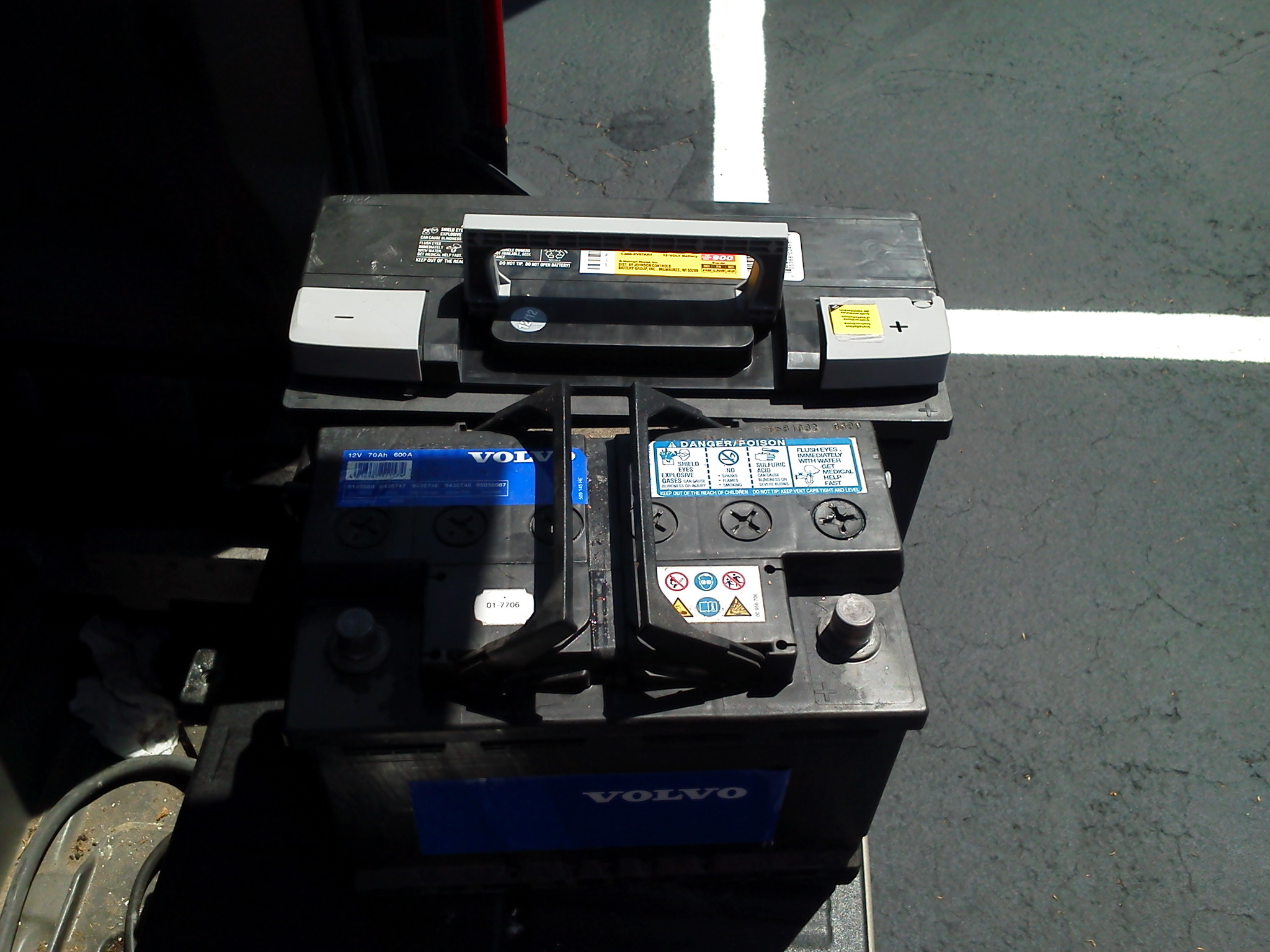

The VOLVO battery finally gave out and I went ahead and replaced it with a group 49 battery which is slightly larger than the original. The group 49 is found in the V8 from what I understand. The best part is that it bolted right in as there are two mounting holes for the battery hold-down bracket.
I made the decision to go with a Wal-Mart EverStart MAXX-H8 battery. You may wonder if this is a great idea given that it was bought from Wal-Mart, but I read pretty good reviews on this particular battery and it was only about 60% of the cost of other brands in this size. The best part is that the Wal-Mart battery has a better warranty than any other brand I looked at. Time will tell....
One thing to note about changing the battery in your XC90 is that, since it's in the passenger cabin, be sure to re-install the battery vent which goes to the outside of the vehicle. This will keep it from off-gassing inside your car.
Two Mounting Holes For Battery Hold-Down (Note corrosion from old battery): MAXX-H8 Group 49 Battery: Difference in Size:
