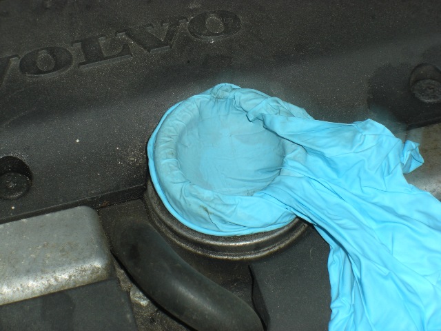

I would suggest that you search the misfire first.
Follow the thread I gave to verify condition of spark plugs and coils. If you ever find oil in the tunnels you can think of the PCV later. Just clean the oil on the coils, spark plugs and tunnels if it is the case.
If you want to test your PCV you can put a glove over the oil filler hole and with the engine running if it is drawn in you have a working PCV. If it blows up (inflate) then have a look at your PCV.
Here is a picture of a working PCV.
PCV Test with Latex glove.JPG (129.4 KiB) Viewed 2459 times

I am going to take the cover off this Saturday and look for any oil, as well as pull the #5 plug.
I went down into the parking garage and put a piece of plastic with a rubber band over the oil fill and it did puff up a bit. I'm getting the feeling it is the PCV. Does anyone know of a video DIY for PCV replacement or a good one with pics for a 2001 V70 2.4T? I found one for a non-turbo 1999.

After going back and reading through this, I have to ask if the PCV being blocked directly affects the way the car runs, or does it just cause the oil blow back that causes other problems?

willie83 wrote:or does it just cause the oil blow back that causes other problems?
Right it won't affect the way an engine run. However has you mentioned unmanaged crankcase pressure will cause problems with oil seals around the engine. The worst is the rear main seal that will require transmission removal to fix. Others seals will be affected as cam seals. Oil leaks will develop around the PCV system and its piping. Oil will accumulate by vaporization in the overhead gallery and in time will deteriorate components. High voltage energy produces by coils can leak to ground because of oil presence. That is why it should be fix when detected. Keep your oil dipstick a bit off its seat to vent crankcase pressure. This will be easier on seals until you fix it. The misfires you have may be caused by something else. The opening of the spark plug cover will tell.
If you decide to repair this link will be helpfull because it is more specific to your model.
