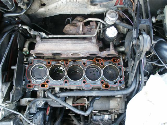

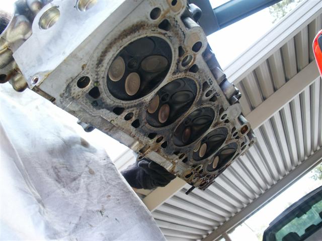

Well, here are a couple of pics from my head removal.
Bottom of Volvo S70 GLT head.
Head gasket from a Volvo S70 GLT, Leaking
It appears to me that the head gasket in this car was replaced prior to us getting it 3 years ago. I also remember changing the cams seals 18 months ago and the cam seals that were in there were after market seals. So, this is what the bottom of the head looks like after our 50,000 miles, mostly grocery store (Kroger) and Exxon fuel, 91+ octane (mostly 93), Castrol synthetic oil for the past 24 months, and it does get it's share of "blown out". :wink:
There is NO sludge in the motor, passenges look clean and there has never been any lifter ticking. The exhaust manifold bolts were loose on the side closest to #1. Also, the studs came out of the head (grrrr). Cams look good and I hope things go back together as well as it came apart. Man, those head bolts were tight.

Oh, my guess is that I had a leak near #3.

Post by byeboy »
Well, as bad as my carbon is, at least my head gasket was doing its job (under the most pressing of circumstances!)...
