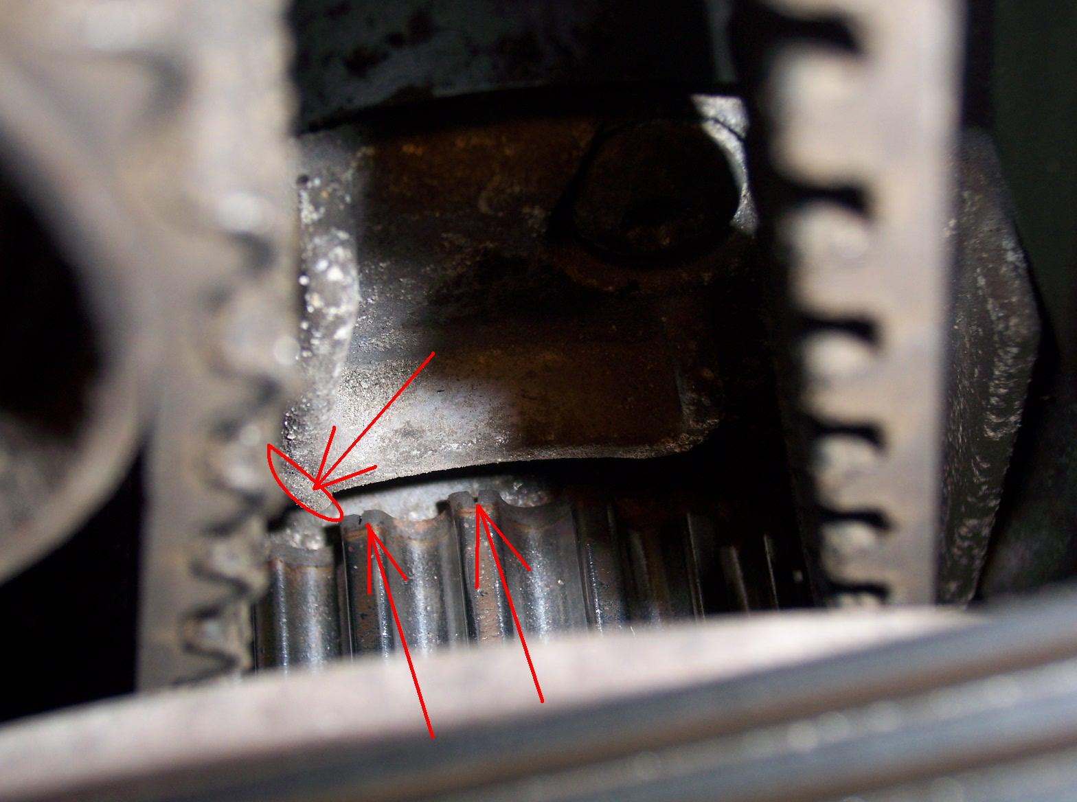

I never could find any marks on my crankshaft, however. I just made some marks of my own when I lined up the camshafts.
oragex
Posts: 5347
Joined: 24 May 2013
Year and Model: S60 2003
Location: Canada
Has thanked: 102 times
Been thanked: 352 times
Post by oragex »
And the barely visible timing marks on the crankshaft gear and engine block - the one on the engine block it's not visible with the belt on, but can be felt by hand, it's a small bump. There is also a timing bump on the crankshaft pulley (not visible in the photo)
