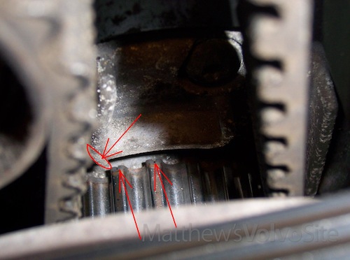

Volvo Forum regular Oragex posted a nice photo of his S60’s timing belt marks… S60 Timing Belt Marks
And the barely visible timing marks on the crankshaft gear and engine block – the one on the engine block it’s not visible with the belt on, but can be felt by hand, it’s a small bump. There is also a timing bump on the crankshaft pulley (not visible in the photo). S60 Timing Belt Marks
