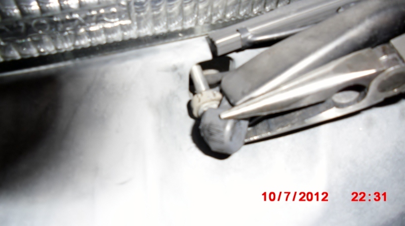

Found the nut, but where/which washer fluid line supplies the headlights? It's a forest of fluid lines and wiring down there.
Cover over the headlight wiper nut.
Right under the passenger side headlight. They come to a 3-way valve. Pinch off the smaller 2 or just the big line itself.

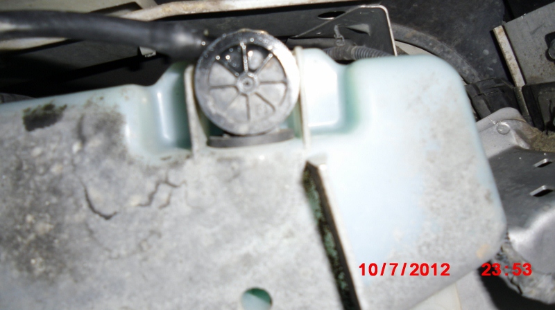

I just found a solution for my 1998 V70 XC that doesn't involve blocking with a screw or pinching the washer fluid line. I followed the headlight washer lines back down to the bottom of the washer fluid tank, in front of the passenger wheel well, and behind the foglight. It looks like the pump outputs to a short fluid line with a T-connection. One branch of the T goes to the windshield and the other branch goes to the headlights.
T-connection from bottom of washer fluid tank, one to windshield and the other to headlights.
CIMG1820 (800x448).jpg (203.3 KiB) Viewed 2627 times

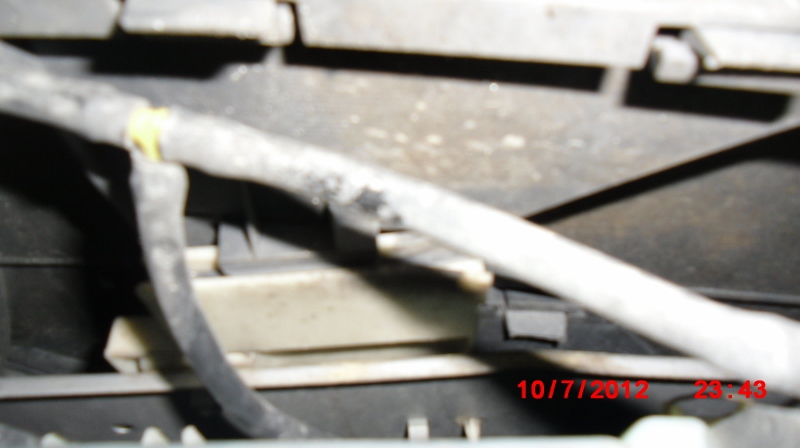

So I disconnected everything for the headlights and connected the windshield line directly to the bottom washer fluid pump. The windshield gets a really good spray now. The rear window pump and washer line wasn't touched and as before. Yes, a lot of washer fluid ended up on the garage floor as I disconnected and reconnected the pump.
Connect windshield nozzle line directly to the washer fluid tank. Remove the lines for the headlights.
CIMG1821 (800x448).jpg (216.17 KiB) Viewed 2627 times

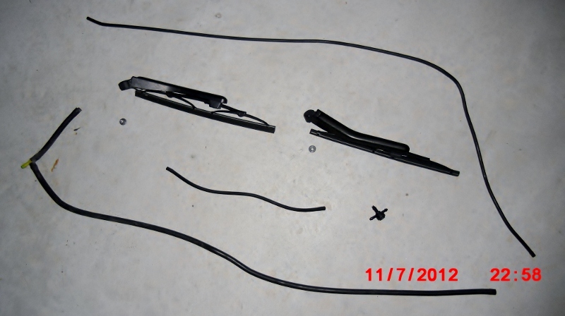

Here are the headlight washer parts that I removed excluding the motors.
Headlight washer parts removed from 1998 V70 XC, left motors. For sale, cheap, slightly used!
