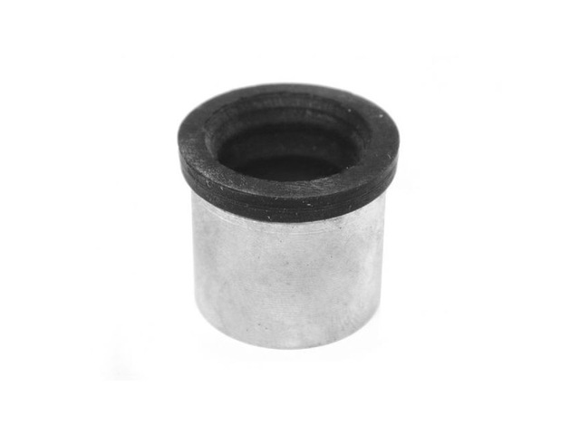

Oil Separator Trap Box Coupler (Volvo PN 8653339) in the PCV replacement kit is a URO make. Any issue with this URO part. If so, I could get this one item from local volvo parts. Any thoughts?

I believe most people have problems with the lines, not so much the box.

Someone here had their URO box fall apart and spit oil everywhere.
Based on my experience with their $&@! Hoses, I'd say stay away.

Ohh, that thing.
Yeah, get an OEM one even for that. The rubber seal on mine was leaking when I went back in to do the PCV system "right" a year and a half later.
FWIW, the rubber lip faces the plastic canister.
