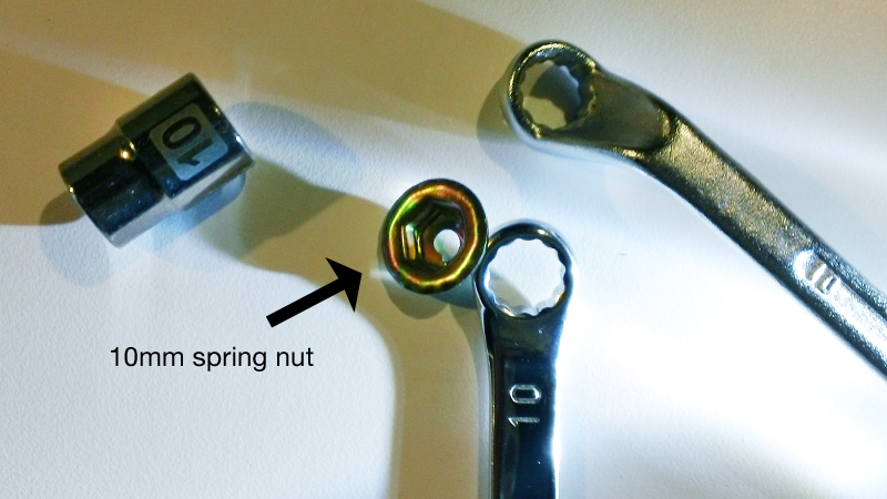

spring nut and 10mm tools I used...

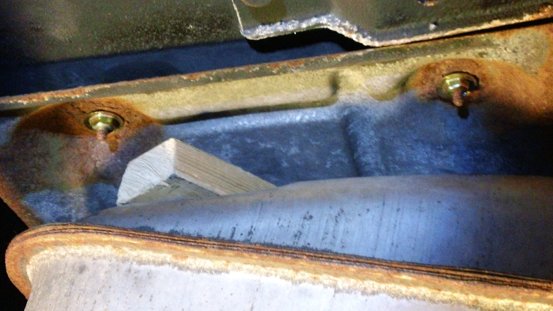

Placing a piece of 1" wood to keep it raised made it easier to turn socket with fastener by hand, then tightening it with 10mm 12pt wrench. The two on driver side were deeper and out of sight. Used patience more than tools to get these up. Driver's rear must be installed from rear using tail pipe as a guide, since it sits 4" to the east of tail pipe.
view from passenger side is clear...
TIP: I had inserted a small magnet inside the socket's other side to provide a glue for fastener, preventing it from falling.
