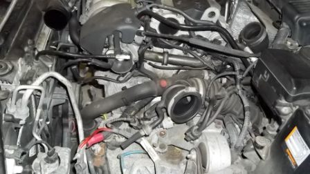

The throttle body is the device that has the accelerator cable connected to it and has a large disc inside it that pivots (depending on how far open the throttle is) to let more air into the intake manifold as you step on the gas.
You will have to remove the plastic cover on the left side of the engine to access it.
I kind of doubt it is your issue, but at 147K, it is due for a cleaning.
Under the throttle body is a somewhat large vacuum hose. I know this will cause "idle" stalling if it's disconnected or broken because that is something I experienced when I forgot to re-attach it after a PCV service.
The attached photo shows the throttle body. The plastic cover has not been removed in the photo. The throttle body is the piece hiding behind the white tee.

- Lt. side.jpg (58.86 KiB) Viewed 2948 times
