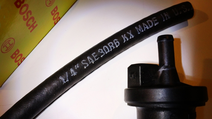

I am working on EVAP. The purge valve is replaced.cn90 wrote: - For the roll-over valve hose:
* No need to remove the bracket.
* Use a pair of needle-nose pliers to TWIST the hose to undo the bond between the hose and its connections. Then remove it.
* I happened to have standard 1/4" heater hose laying around. It fits the "roll-over" valve nipple perfectly, but is a tad too small form the other end. No problem, simply enlarge the other hose's end a bit using a pair of needle-nose pliers.
* Add one drop of oil to each end to ease insertion.
I will replace the two 4" section of hose on either end of the roll-over value near the fuel filter.
Does 1/4" hose in the picture needs a clamp, since it is not a volvo part?
I will stretch one end, as cn90 suggests above, for it to slide over the larger diameter plastic line.
- Posts: 11912
- Joined: 25 Jul 2009, 14:03
- Has thanked: 311 times
- Been thanked: 817 times
I've done this on several 850s now, always used generic fuel hose and clamps.
xHeart
- Posts: 3321
- Joined: 03 Dec 2011, 08:05
- Year and Model: 2.0/3.2
- Location: Great Lakes - USA
- Has thanked: 116 times
- Been thanked: 119 times
Thank you!.erikv11 wrote:I've done this on several 850s now, always used generic fuel hose and clamps.
Replaced the two 4" connecting rubber hoses at the either end of roll-over valve. The word Vent is embossed on it. Old hoses broke into pieces.
The hose section directly above the fuel filter requires the valve bracket be removed. It is safer then to pull off old and insert the new on to the line.
I may have defeated P0455, will confirm later.
