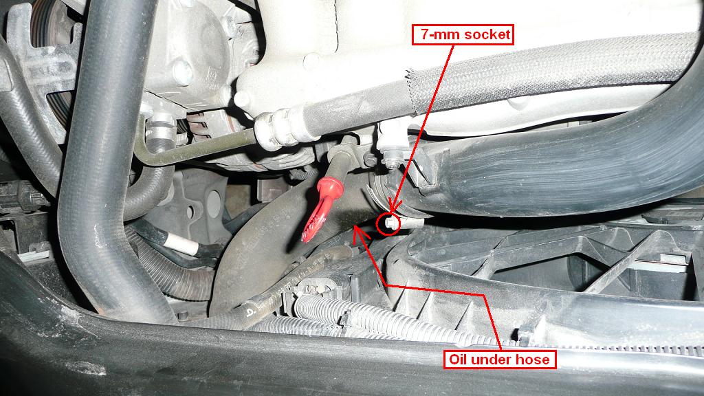

My 2-005 XC90 2.5T with 103K miles has had code P0101 for a few weeks.
Car runs fine no hiccup.
Installed a brand-new Bosch MAF, exact same thing as in the car.
No change.
Then I read somewhere the Turbo Hose can seep enough oil and leak enough air to create this MAF error code.
Ordered a Gates Hose from ebay.
Turned out the Factory Volvo Hose was probably made by Gates b/c the clamps are made by "Norma" brand.
So if you buy Gates hose ($35), you probably get OEM hose (which is $60 at dealer for this stupid hose).
1- Used 7-mm socket (better than flat screwdriver).
2- Mark the old hose with Sharpie so you know which end goes where.
3- Once the old hose is out, compare it with the new hose, you will know how to install it.
4- The old hose: there is oil/grime underneath, I spent 30 min. looking for any holes or cracks. Could not find any! So my theory is...the hose absorbs oil over 100K miles, then developed microscopic holes and leaks enough oil and/or air. There are a few drops of oil on the subframe.
Anyway, reset the MAF code P0101 and will report back if this code goes away or not.
