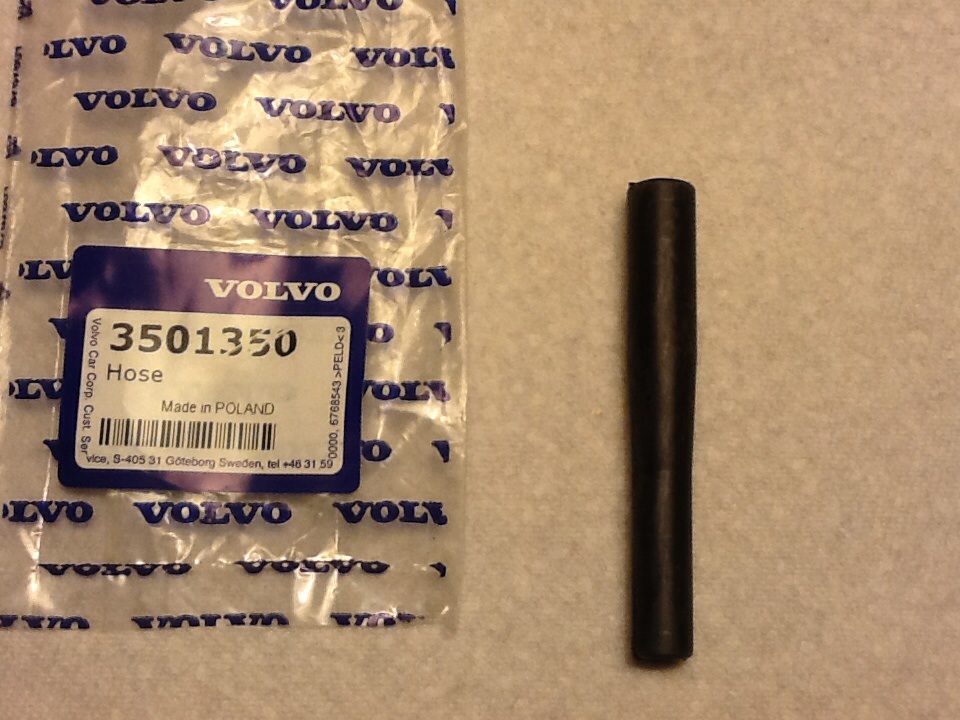

I bought it from Volvo. You may be able to do it generic but It is 2 different diameters, one end wider than the other.

Can anyone post a photo of this hose or even better, the Volvo part number? Would be much obliged.

hmmmm I thought we were talking about 9463088. With part number and more photos:
https://www.matthewsvolvosite.com/forums ... =1&t=60269

I have the access covers off on our 850 and can see that the short hose is what we need,
but is this VIN dependent long/short or are they 2 different hoses that all 850s use?
