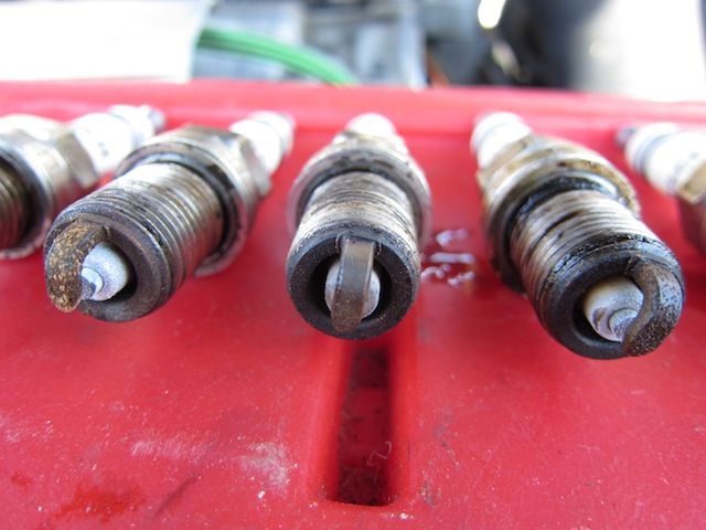

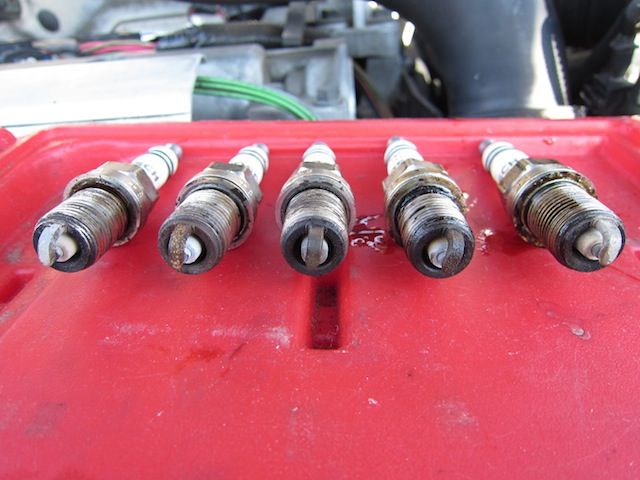

This is what the plugs looked like after a 450 mile trip through the mountains and why I took it to the shop. The shop said I had a couple bad coil packs so I just replaced all five and the plugs. The car idled nice and smooth. After my last trip in the mountains the semi rough idle is back that was there before the new plugs and coils. The car seems to drive and accelerate just fine.
1 and 5 where pretty white, 2-3-4 where rusty looking and had deposits on them. 4 and 5 looked like a dipped the threads in oil and on 4 the electrode on the plug had oil on it. I think the oil is from bad o-rings in the head? I know it is not from over filling or leaking from the fill cap seal. I replace it every oil change.
