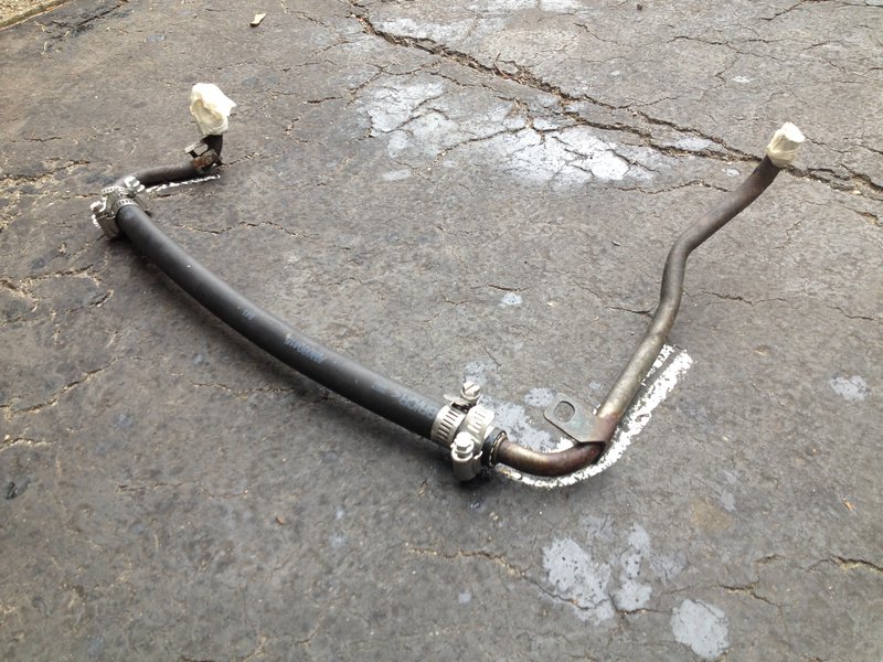

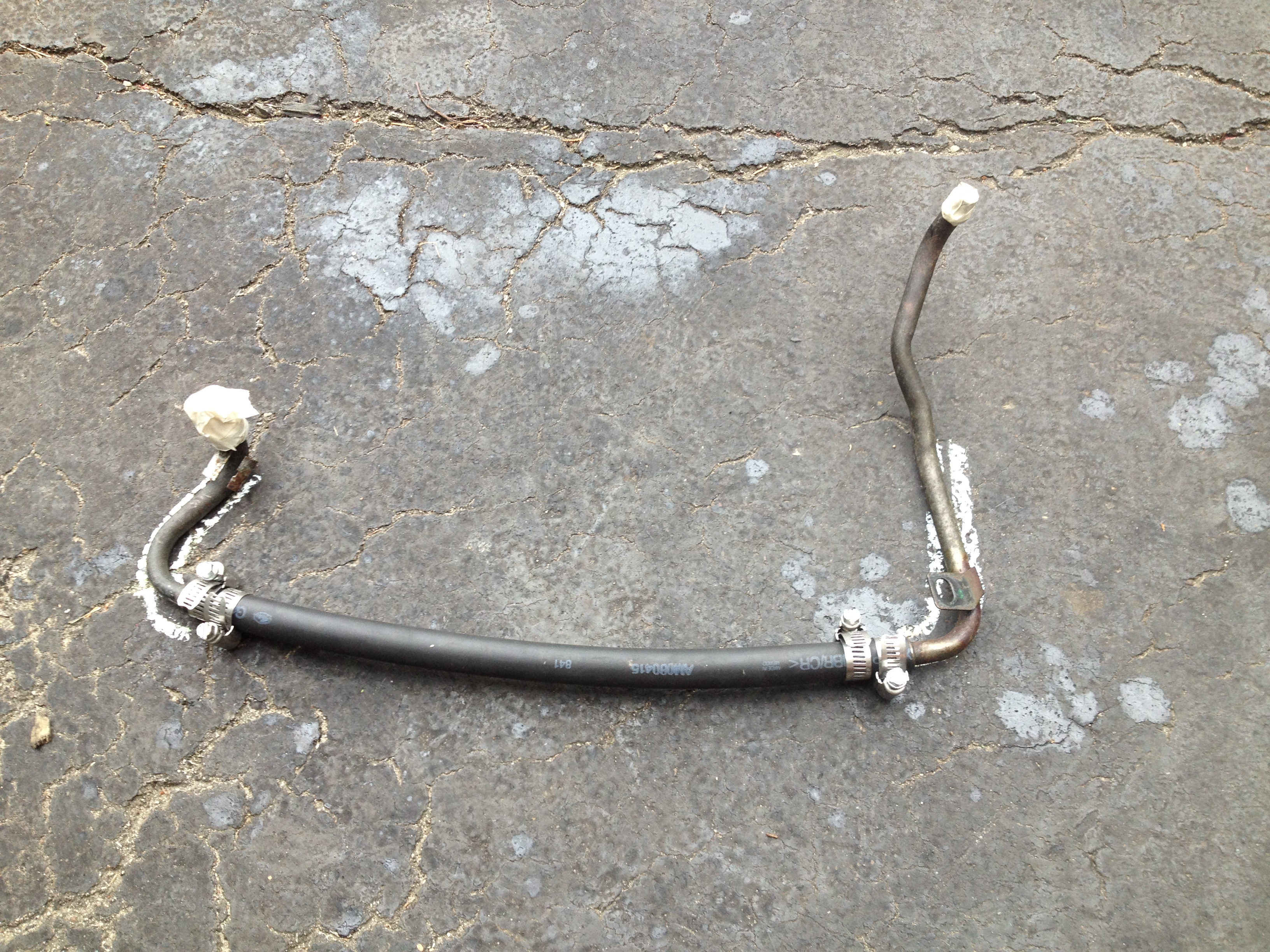

Excellent write up. I rebuilt my lines using 1/2" oil/trans cooler hose zero leaks from the line itself but it is leaking at the o-ring of the thermostat because I couldn't get the o-ring seated properly. Did you guys insert the o-ring into the thermostat or did you insert it on the oil cooler line? I placed it onto the oil cooler line, but it wouldn't seat properly despite tightening the bracket and yes I did flip the bracket.
Let me know please.
Here are some tips to ensure you keep the routing the same, trace the existing hose outline on your driveway using some chalk (steal some from your kids). Use double hose clamps, preferably the good quality ones from Sweden that the dealer gets. I prefer them over Oetiker because you won't have access to tighten those once they are installed. Screwdriver tight is not enough I found, use a ratchet to tighten them, the hose is otherwise a bit loose on the line.
Let me know please.
