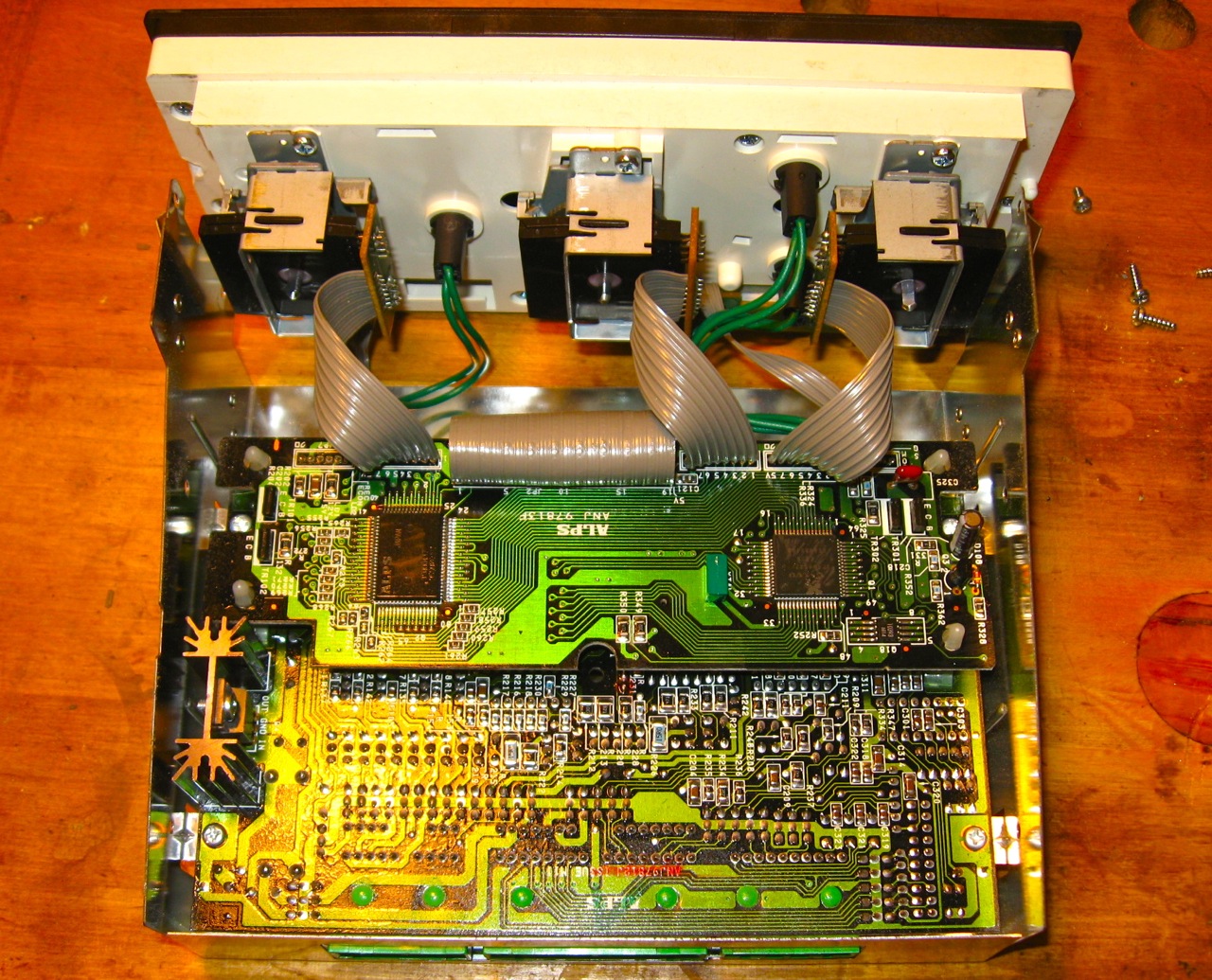

I haven't tried cleaning the switch contacts inside the ECC unit, but that's something I would probably try if I were in your situation. I took my ECC unit apart last year to check for capacitor explosions (I found none) but while doing that I noticed that the front panel switches are accessible -- you can see them in the picture below:
Front panel of the ECC unit seen from inside
You can loosen the screws and detach the electrical connector and perhaps clean out the switch contacts -- it may be worth a shot and if that fixes the error code it will be less expensive than buying another ECC unit.

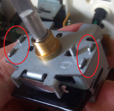

After removing a retaining nut on the switch stem, four metal tabs need to be bent to allow removal of one piece of the metal ‘cage’. Here the four tabs (two on each end) are straightened out:
Pull this part of the bracket and the attached switch stem out from the rest of the switch.

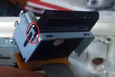

Now, two tabs on the side need to be pried out a bit to free the black plastic case:

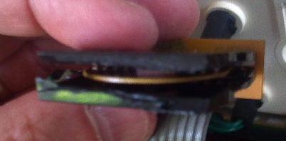

At this point, I noticed that I could gently pry open each side and see where the contacts were. However, the box was hinged at the top and would prevent a good cleaning. So, I needed to cut that hinge (I used the scissors on my Swiss Army knife) in order to get fuller access:

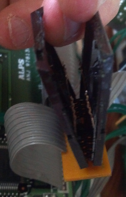

Once the hinge was destroyed, I could get the contact disc out (you should remember how it was oriented inside the box) and expose the internal contacts:
A paper towel soaked in contact cleaner was used to clean both the disc and the contacts inside the case.
Here is the cleaned-up disc:
