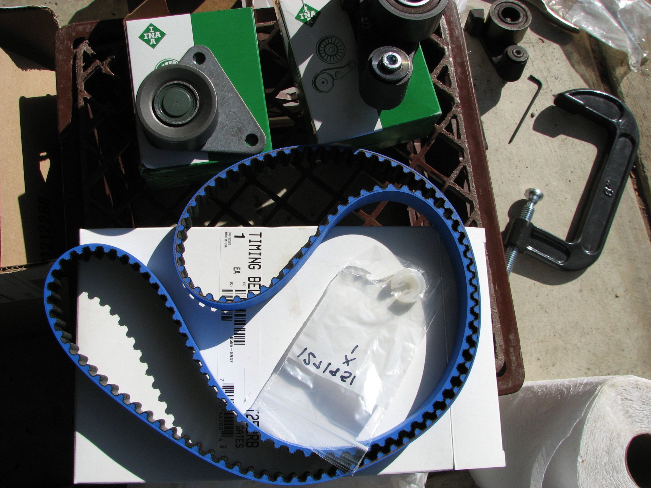

TY!! guys for all the suggestions. I went with a gates timing belt kit from 1aauto in mass. free ship and quick and i actually got some quality parts. Anyways the gates kit consisted of..... tensioner pulley is INA, idler pulley is INA, Tensioner is aisin warner, and belt didn't have a name on it just a number (252 dunno if thats teeth count) but i think its just a regular gates belt. It must of been a gates belt (the blue one in the picture above is the best one gates offers i think). The gasket was of better quality then i was expecting, and last but not least..... the water pump! With no name on it made in china lol. i will get the part numbers as they are on the box and in my car to see if we can determine what brand exactly is the water pump. This is where they were able to make the kit cheap i think and this is what everyone in all the thread i read said to not do and go with the oem water pump. To be honest it looked of very good quality. I will keep you posted if anything happens got my fingers crossed and really am not worried except i didn't use a torque wrench so i'll have to get one and do that. Gates is a reputable parts company and for it to come with all parts the same as fcp except water pump and belt which is just a better gates belt For 280 is a deal i think. Saved about 70-100$ from the oem. The oem volvo kit is like 500$ but i didnt even notice this ----> http://www.ipdusa.com/products/9220/120611-timing-belt-water-pump-kit they had this kit for 10$ more! i feel like an idiot now :/ well who knows maybe it will last! What do you guys think about this kit i got from ----> http://www.1aauto.com/1A/TimingBelts/Volvo/850/GAEEK00167/698713/1994

You will soon find out:
- WP: Aisin is the king and use only the green gasket that comes with it.
- HEPU WP is good too. Although HEPU gasket is good, people here would say Aisin gasket is better.
- Chinese WP is a pure gamble.
This is a big job involving a lot of labor, you don't want to "penny-wise-but-pound-foolish". That is what the British people would say.
