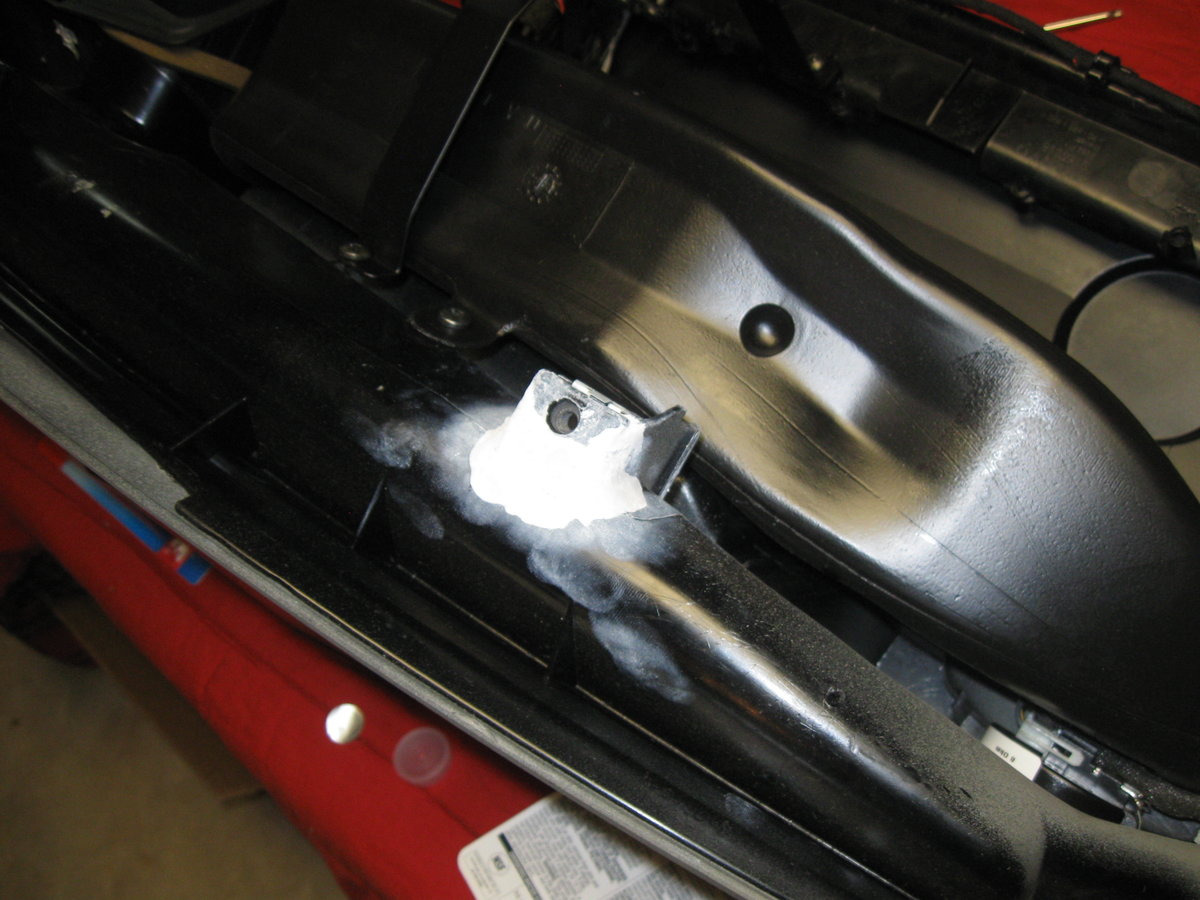

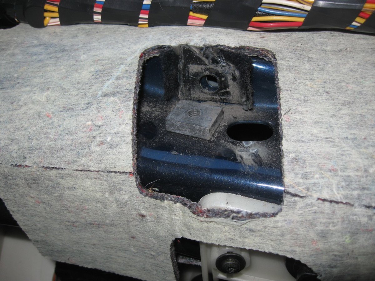

ah, THERE's the attachments... here's a broken mount, and a rebuilt one using the jbweld marine putty. I can't fathom how a few 1/16" pieces of plastic are supposed to hold a dash in place. I also fashioned straps out of ductwork material to pull it backward because it seemed the problem is that it pulls away rather than up/down.

Yikes!!! Afraid that will do more damage to the back of the dash. Part of those mounts are part of the duct system. If they break away more, they will cause large air leaks in the vent system.
When you go back there to fix it, get some of that metal backed AC duct tape to patch up the duct work cracks.
