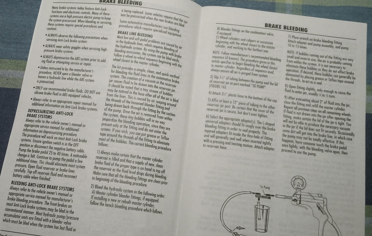

A post in support of Jason's pressurized/vacuum "solo method".
