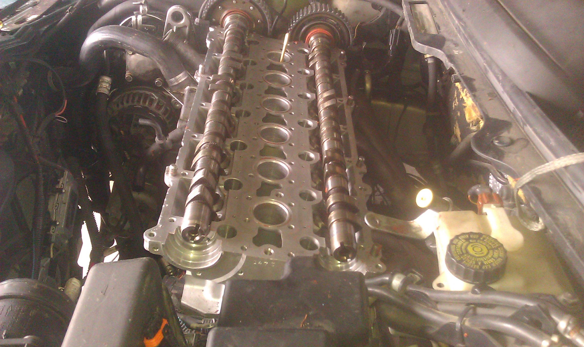

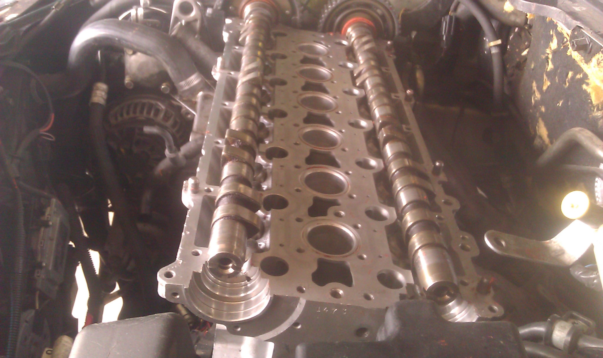

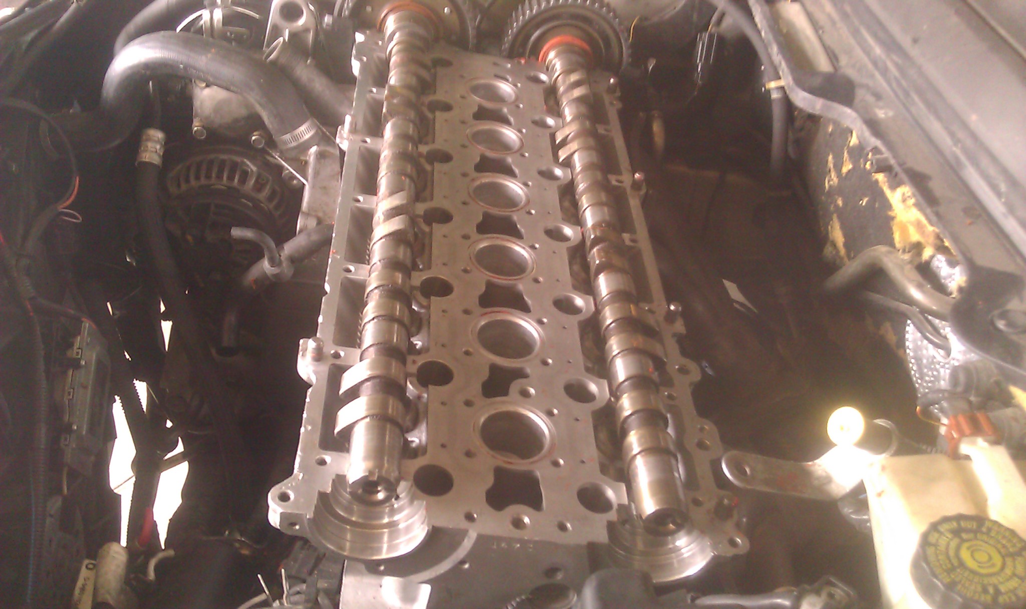

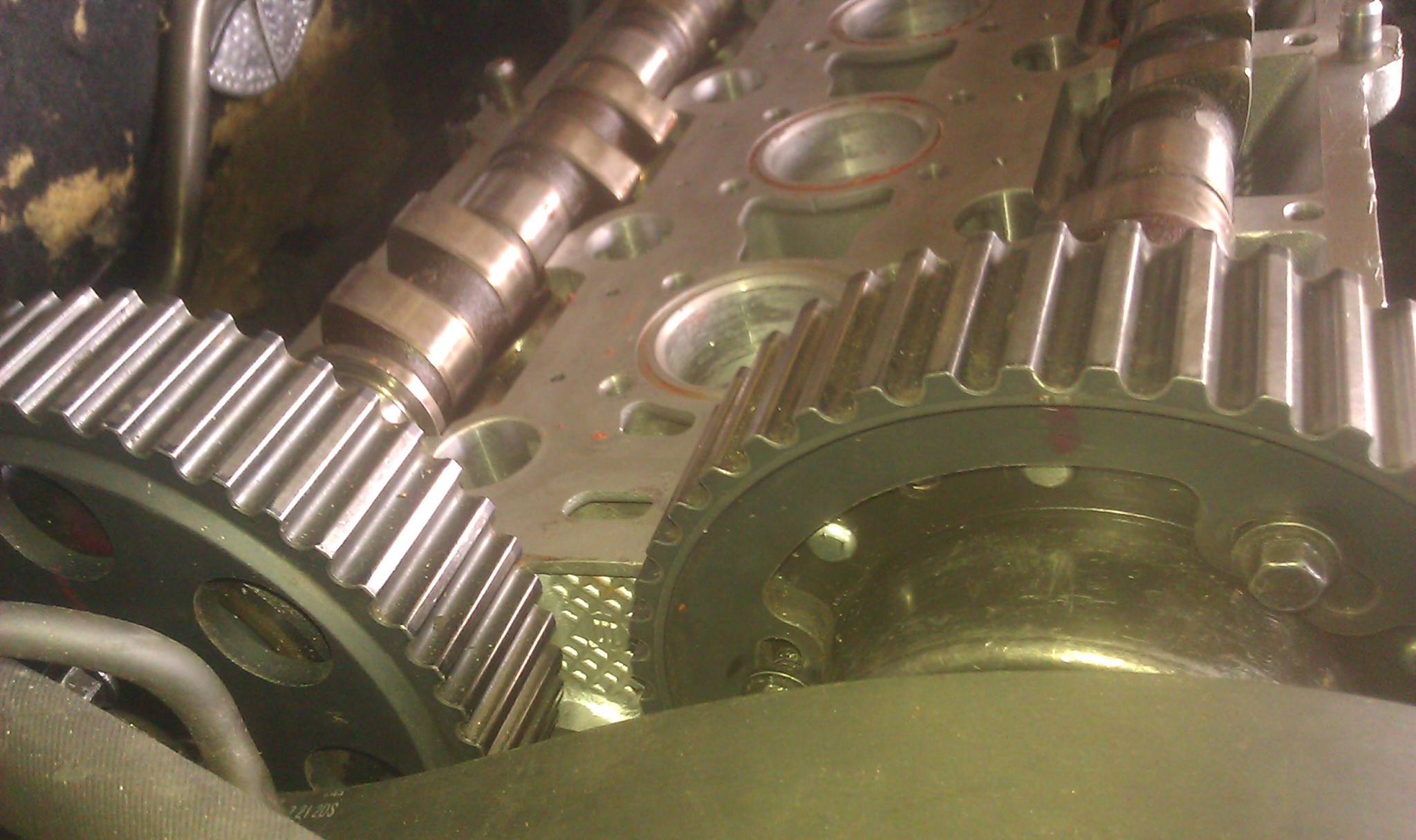

those were Mike's photos, i will attempt to load some up in a sec. i have seeen the VVT setting tutorial several times, in a few photos i have seen that the bolts are in the middle or toward the right and the open bolt guides (slots) are to the left. again perhaps the crank is off. where the 3/8 extension stops when i turn the crank anti clockwise, cyl 1&6 are approx halfway down and rising. 2&5 are almost at the bottom going down. 3&4 are at the top going down. are the pistons in the right spot? not sure how to add photos, i will try now.
here is how i see your configuration. obv. this is not right as it cant be locked down
here is one way it may go
same shot other side
or possibly this way. this is the intake 180deg rotated.

the pictures are reversed in the order i wanted to show them. i think it is possible that the crank may be my problem. doesn't each rotation bring it back to the same spot? not the cams, they need 2 cranks to return to the same spot, right?
