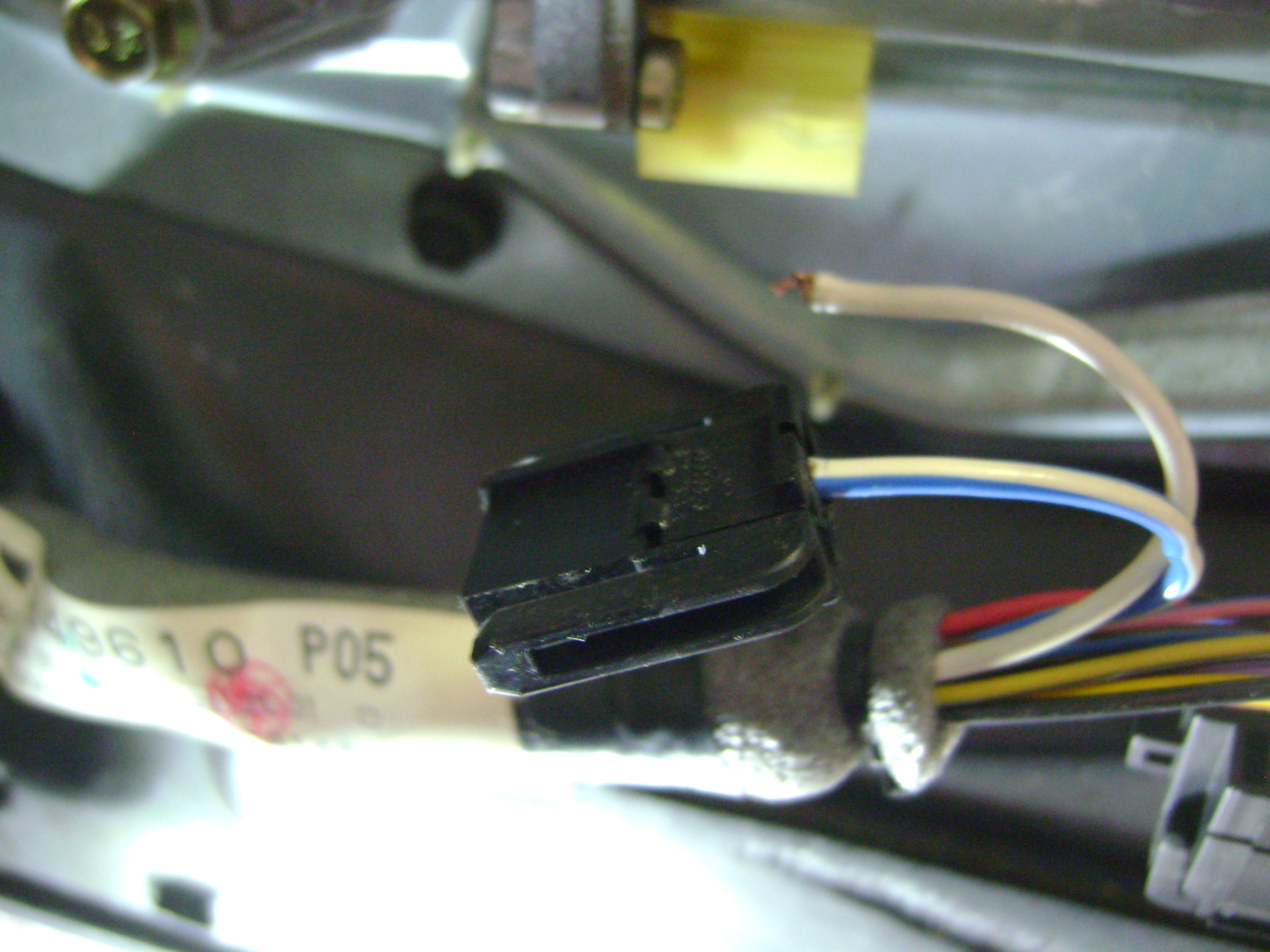

96 850 GLT Front Passenger Window won't go down
joe_pinehill
- Posts: 208
- Joined: 30 September 2013
- Year and Model: 850 1996
- Location: United States
Re: 96 850 GLT Front Passenger Window won't go down SOLVED
I took the door panel off, got very lucky and spotted one of the wires in the connector that powers the motor was broken off. I was able to take the connector apart, re crimp the wire, and window is working fine.
