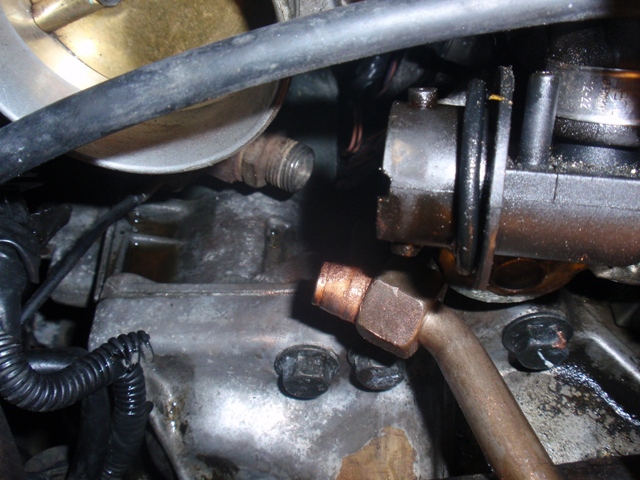

This! The EGR tube being miss-aligned was the most time consuming issue I had. The only other real issue was the new exhaust studs/hardware provided with my eBay exhaust manifold being the wrong size & cheap junk.Ozark Lee wrote:The quality of the OBX, for the money, is terrific but it is a total pain in the butt if you have EGR. The bung for the EGR is inset and at a different angle than the OEM and the EGR line really doesn't like to be bent. It can be done but it is a real pain.
...Lee
I posted this link in xHeart's similar thread earlier, but here's my experience with the cheap eBay exhaust manifold. The one I bought was sold as DNA Motoring on eBay, but it appears that the KOSpeed manifolds are the same thing. https://www.matthewsvolvosite.com/forums/vie ... =1&t=45649
These are the same pictures from the link, but I'll go ahead and point this out.
The difference in the angle of the EGR bung shown here (low and on the right) you see the shiny new stainless manifold's bung is angled down a little more than the original manifold.
That angle caused this much miss-alignment with the EGR valve and tube. That tube with the copper tip is supposed to fit on the open threaded bung sticking out from under the throttle body. Ozark Lee is spot on, that tube ain't easy to bend. There was a lot of trial and error, install, remove, bend, rinse & repeat to get it to fit correctly.
- Lee
