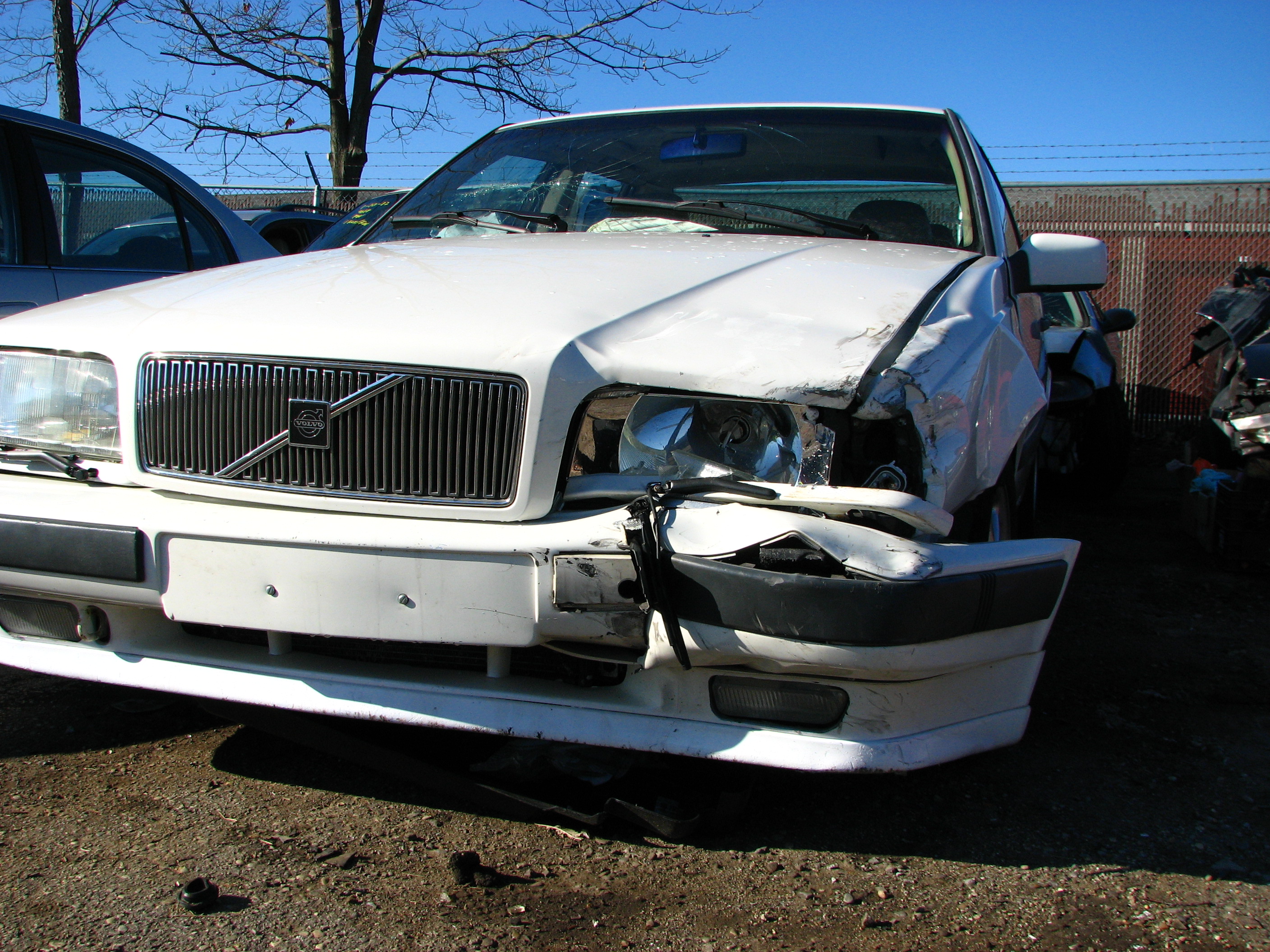

I found a nice replacement radiator at the yard on a '98 V70. I had realized they welded those better in '93.
My '93 was hit in exactly the point of the radiator mount. The plastic part was torn from the radiator and still bolted to the unibody.
I removed that bolt, rust and all, without PB or WD.
The '98 at the junkyard, I literally had to break both bolts because of the inferior tack weld of the nut. Careful not to break the plastic tank mounts.
A two bolt extraction took nearly two hours. I did get it. $35.00 for a nearly new Valeo was worth it.
This is where the frame damage was that I had straightened. Radiator mount.
I did straighten the frame and the replacement radiator has about 8,000 miles with no issues.
Frame straightened. Radiator installed. Coming together.
Sorry for the blur in that photo above. I was a bit excited to bolt things together.
It was totaled. I did not let it go.
It is much better now.
