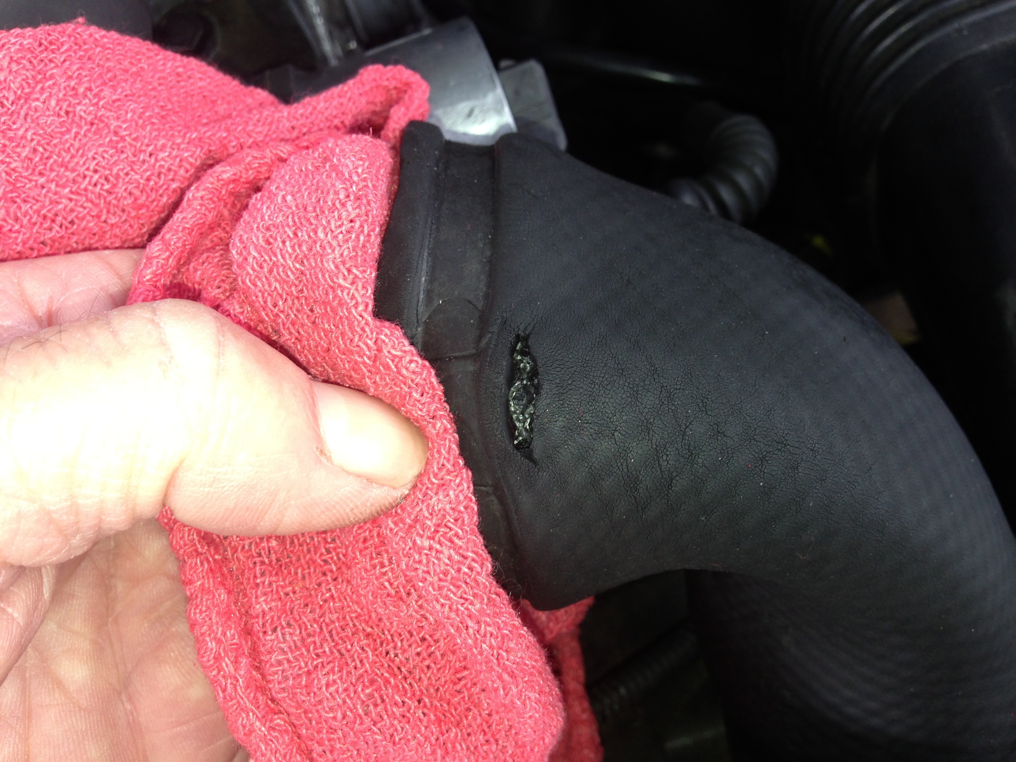

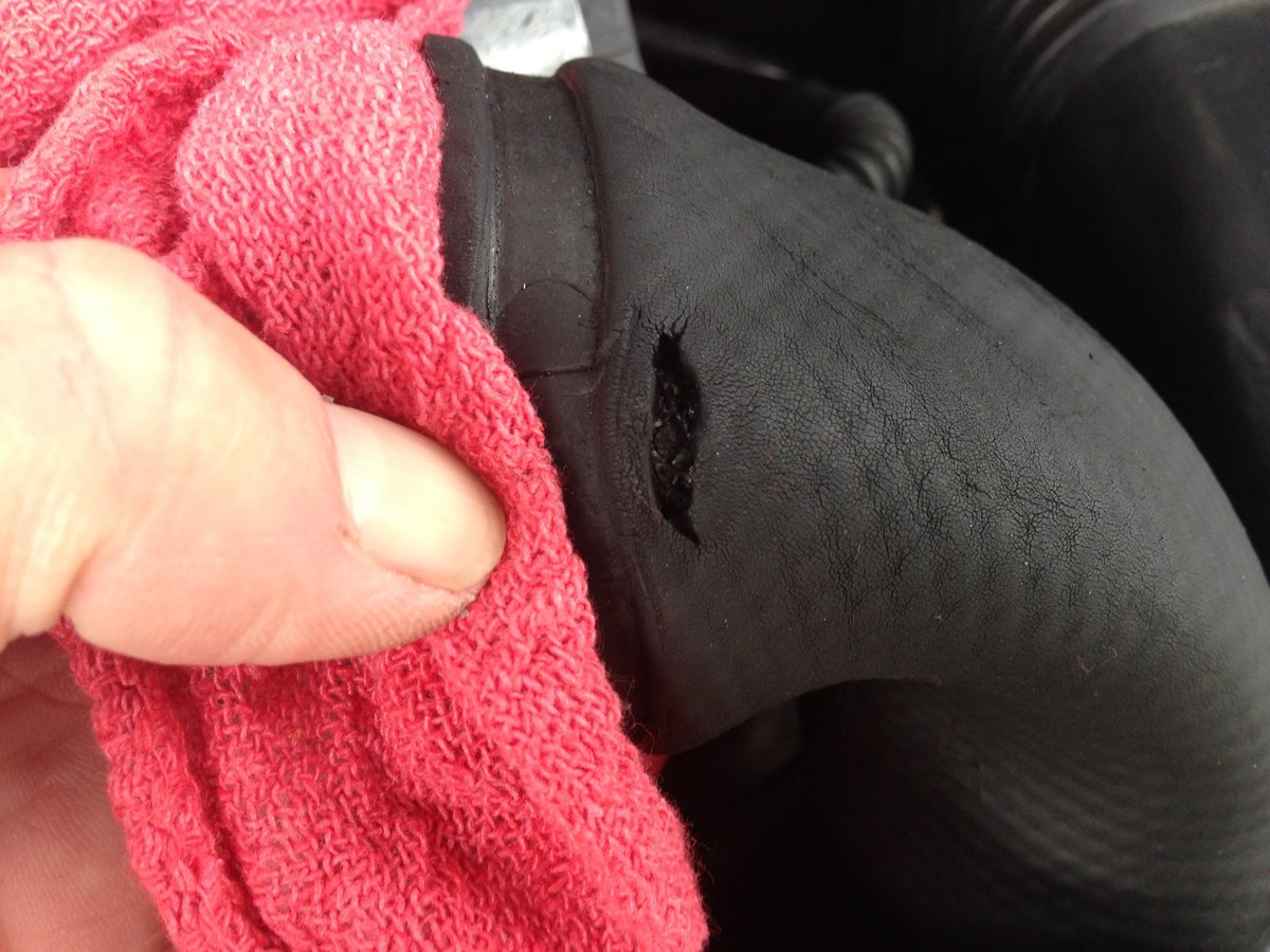

Intercooler hose that attaches to throttle body
Found bad intercooler hose.
Since some of my grounds from engine to chasis seemed suspect I bought 4 gauge cable with ends at autozone and attached to the transmission housing using one of the starter mounting bolts.
When doing this I removed the intercooler hose that attaches to the throttle body. It was then I noticed a one inch tear in the hose. It goes almost all the way thru the hose it looks like there is some reinforcing mesh on the inside of the hose and it didn't make it thru this. I would say its 99% thru and what's left looks porous . Perhaps as hose heats up its letting air in.
I'm putting a new one on this evening.
Torn intercooler throttle body hose can better see mesh lining

Post by phils94850 »
thatll do it... go silicone and u wont have issues..

Post by jacsil »
Well I went the less expensive route. URO brand. Looks like it will be a bit tough getting it on. We will see. Hopefully this does it
