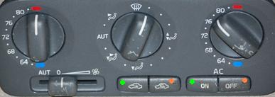

Just to rule out the simple:
What is the Temperature dial set to?
Is your air selection set to Fresh or Recirc(ulate)?
What is the Function dial set too (face, feet, defrost, ...)?
Do you have snow or ice on your windshield or the trough between it and the hood?
What fan speed do you have selected?
Are you driving during the night, or the day when any indicator lights are less visible?
(more below)
" * When the function selector is in the defrost setting, the A/C will automatically be ON if recirculation is not on and the blower control is not in position 0. ... NOTE: If your windows begin to fog or mist, check that the recirculation function is NOT engaged."
**When the function selector is in the defrost setting, the A/C system is ON and the blower will function at its highest speed if it is in the AUT position. ... * Pressing the ON section of the button for more than 3 seconds activates a timer function. Recirculation will then always operate for 5 minutes ..."
(Green and Orange LEDs superimposed. Only one will be on per side.)
Additionally, you had a high of 9° F (-13°C) and a low of -8° F (-22° C) in Kimberly, WI yesterday, correct?
What is "warmish" to you in ° F considering the heater core would have swing fresh air 50 degrees just to get to 59° F?
How hot would the heater core have to get for it to change incoming air (X) to your desired/selected temperature (Y) in relation to the plastic core ends and housing?
What does the coolant temperature gauge read?
What speed are you driving at?
Are you sure you do not need one of these?
