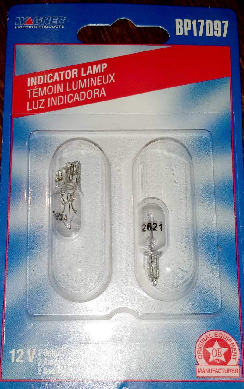

Andrew sent this in to me via email:
Long story short, I had a hard time finding 2821 bulbs. Both Wal-Mart and Canadian Tire listed the 2821 but neither stock them or could order them. I then went to my brother who works counter at our local Napa. They listed the 2821 but he could not order them from any of his suppliers. He did some research for me and found that Wagner sells them as a BP17097. We ordered a pack and low and behold packaged as the BP17097 were 2821 bulbs. The wagner number also cross refs to a philips number. I have attached some pictures.
I could not find any cross ref numbers to 2821 other than W3W before getting the Wagner part number.
Also -> Amazon link
Find a place that carries Sylvania or Eiko bulbs like Advance, Autozone, O'Reillys, and so on. Find what's local, check their website, do a search for "[auto parts store name] 2821 bulb", and call first to verify they have them in stock. NAPA generally carries just Wagner, but they can cross it to any Sylvania number.
