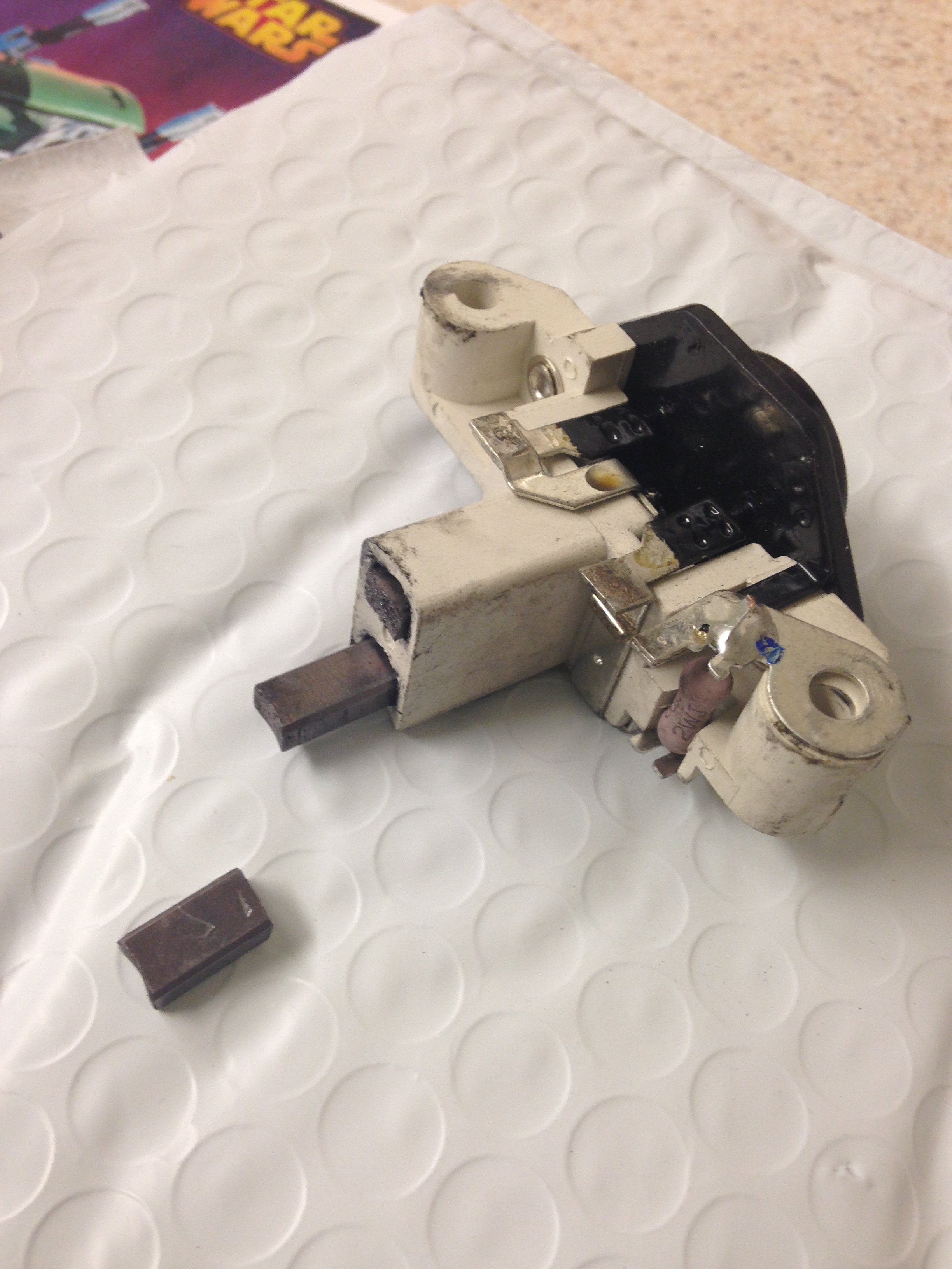

Any advice on installing the new regulator? I just broke mine trying to get it into place.

I'm trying to reinstall it with the alternator still on the car. With those two prongs being so long it is difficult to compress them to allow the holes for the screws to line up. I just replaced the coolant and I'm trying to avoid removing the alternator which would require me to drain the coolant out again.

I bought the cheap no-name ebay one and I hope I'm not sorry about that in the long run.
I don't see anyway to release the old brushes, it looks like the pigtail wire, if it has
one, is crimped in the back.
