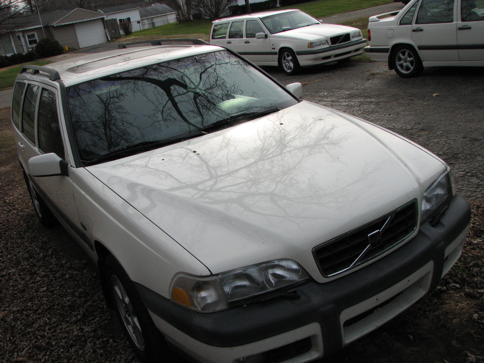

I had just ran the codes on my new purchase today, the 1998 V70 XC and P0455 was the first code to come up among others.
I will likely wait until the spring to really dig into this vehicle, but I will refer to this write up for sure.
Nice job.
Awaiting its turn.
Awaiting its turn.
The previous owner also had topped off the tank completely when gas prices went down, at which point the fuel gauge stopped working. I believe it caused issues I had read about regarding the evap system as well.
I figure I will go through the whole thing. I have already grabbed a fuel pump from the pull yard.
