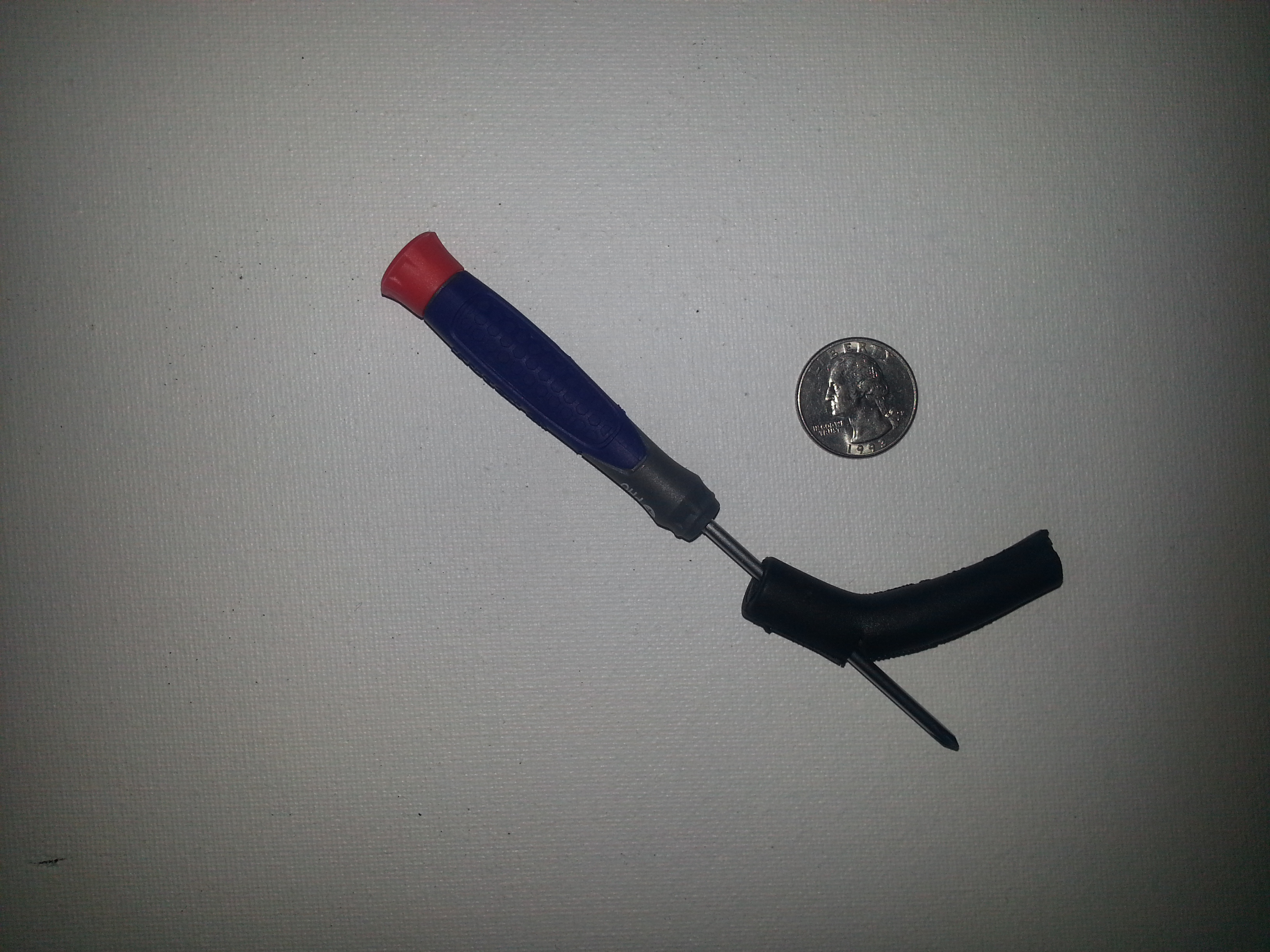

So here is the latest update: I went to the Midas again because they have done so much for my car (brakes/struts/some sensors to chase the above problem) that they do a lot for me for free. I told them to smoke test the gas tank (which no one had done before - amazing) on suspicion that my intermittent problem was related to fuel vapor buildup that should have been returned to the tank from the canister but there was insufficient vacuum. Sure enough there was a leak over the gas tank. They used the access panel in the floor of the trunk to diagnose that a four inch length of vent valve hose was leaking. Replaced the hose and will update again after a few days of driving if the problem is solved, but so far so good after ~20 miles.

bloodrootfc
Posts: 16
Joined: 25 April 2014
Year and Model: 1998 S90
Location: Connecticut
Post by bloodrootfc »
Photo of the leaking hose attached:

SOLVED! After a couple hundred miles and a dozen drive cycles, still no codes. No stumbling. It was a vacuum leak on the gas tank end of business.
