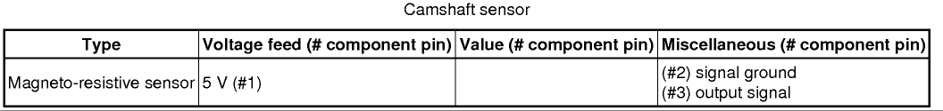

Talked with the Mechanic who did the work last night. He told me that the ECU is the original one to the car. Assuming this is true, where can I go from here? I remember vaguely that when we purchased the car, the Cam. Position Sensor was giving fault codes. After taking a look, the wiring had been butchered to the sensor (wires were still making contact, but the senor looked like it needed replaced. There were wear marks on the very top of the sensor?). But this sensor was still working enough for the car to start and run. After ordering another sensor, we noticed that it was a completely different style (the original had some metal on its casing, as compared to the new one which was a completely plastic housing.) Which leads me to my questions,
Is there anyway to test the sensor to make sure that it is working correctly?
Is there an ECU pin-out schematic anywhere that I can use to ohm test the wiring harness to make sure there aren't any open wires?
What are some issues that would cause it to not spark?
What should be the next thing that I test?
If it comes to it, I'll take the plunge and get a Vida Dice, but I'd like to exhaust all other options prior to doing it.

Cam sensor pinouts for testing on my 2005 P2 - I think you have the same..pin one is 5V check there first.
