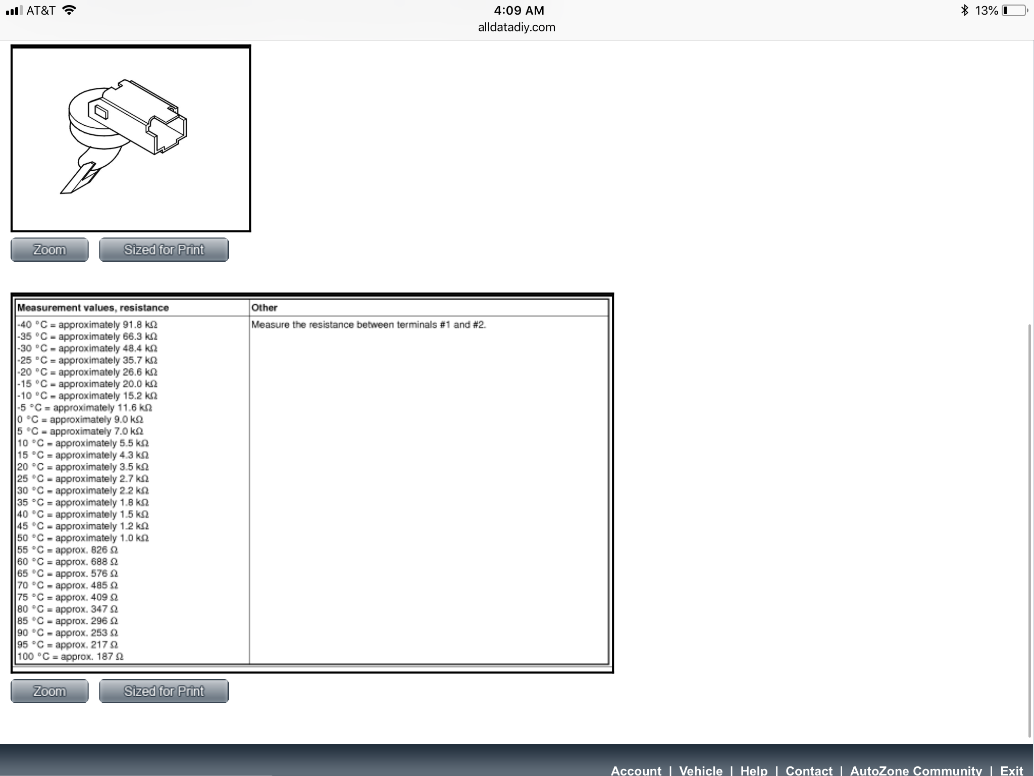

thorv70t5
Posts: 18
Joined: 10 October 2009
Year and Model: V70T5,2001
Location: Corpus Christi, TX
Has thanked: 7 times
Been thanked: 7 times
Post by thorv70t5 »
Posts: 35272
Has thanked: 1497 times
Been thanked: 3810 times
Found this on alldata
Part number 30665118
