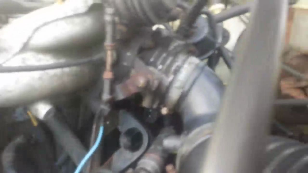

MAP sensor is in front of driver inside a galvanized metal enclosure. It has a hose from intake manifold running to it.

i checked the Hoses to the MAP sensor and they Looked fine. i have pretty much checked ALL the vacuum lines and any that needed replacing were replaced.

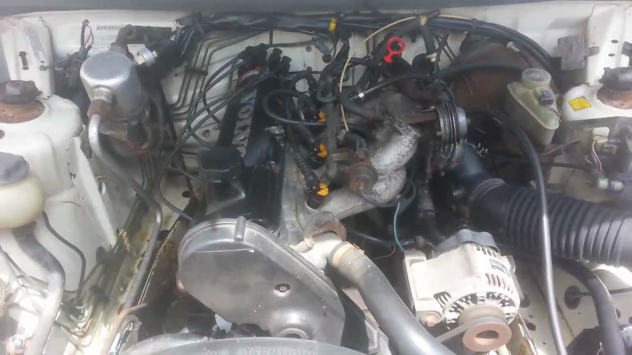

i am replacing the Exhaust manifold gaskets they need it, im also replacing the intake manifold gasket

car barely wants to run or idle at all. currently i have both intake and exhaust gaskets on the way to me. i have everything apart and ready to \go back together.
