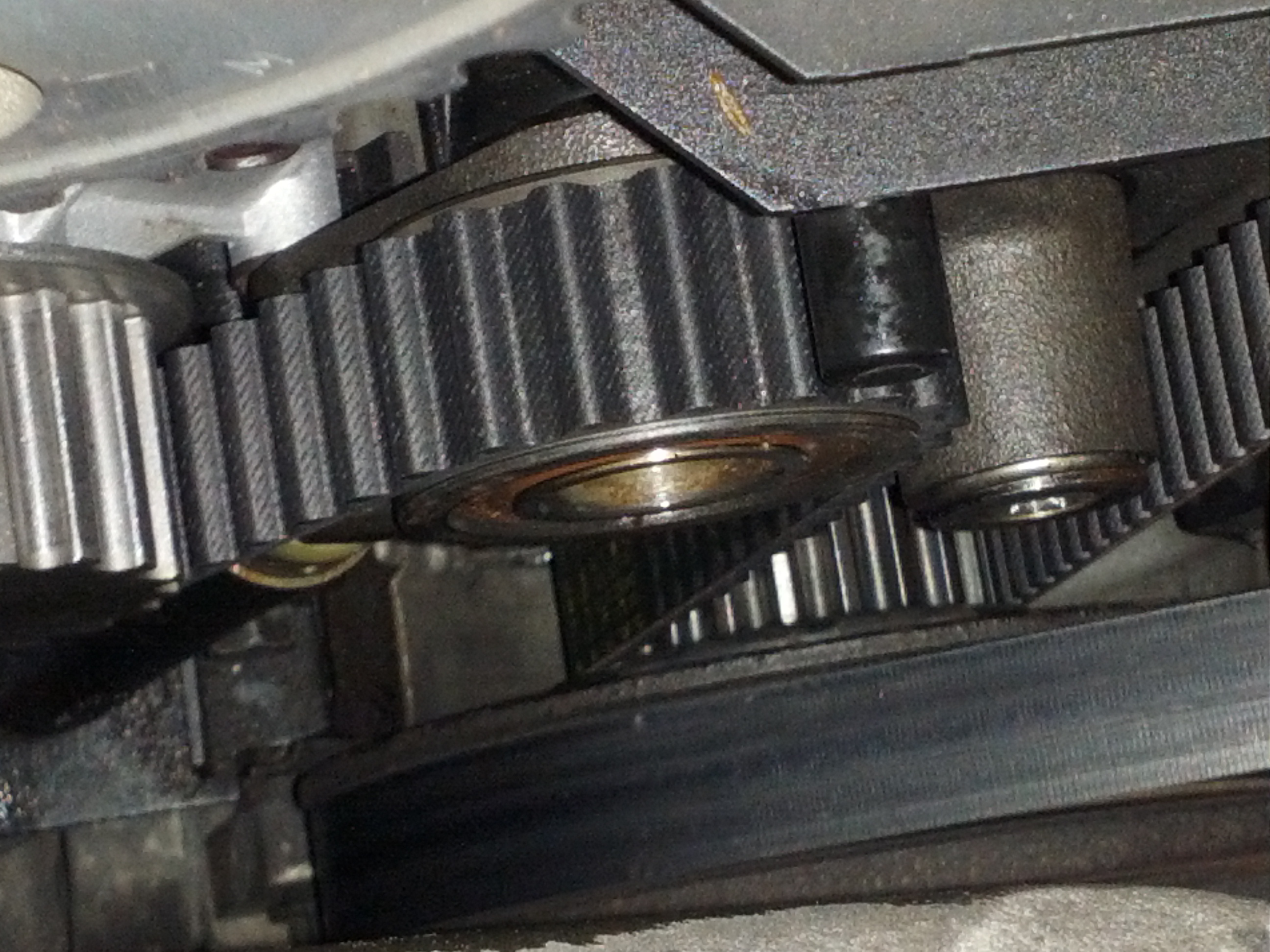

I took the timing cover off and the whining now gets a little more worse when the engine warms up. At 1500 2000 rpm i hear a crackling with the whine and i attempted to twist the belt and it doesnt go to 90 degrees from the exhaust cam to water pump. Too tight?
I suspect the tensioner roller but the mechanic guarantees it was changed.
I attached a pic from the tensioner roller area. The thing is i dont think the roller and the tensioner are new because the have some kind of grime looking used parts.

That tensioner pulley does not look new.

The parts look new to me but that doesn't mean they are good. If it is making noise, the installer should take it apart and double check the parts. It would take 30 minutes to remove either roller, check it for binding and smoothness and reinstall it.

The tensioner pulley is clearly rusted. It does not look new.
I just did my wagon two months ago. The one I changed out looks better than the one pictured.(not the one in your video)

Then have him show you the parts he takes off, looks old to me as well. You can isolate the noise with a oil can with a long nozzle and lubricate the centre of bearings until noise disappears, it will tell you which one is noisy. The idler pulley has a cap you need to remove on access drive
