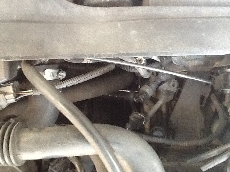

Thanks again Lee, I am a bit of neophyte, and am not exactly sure where the vacuum line is for the fuel pressure regulator. I looked at the regulator on the bottom of the fuel rail, but no line to it. I took my intake hose out of the way but cannot find where metal meets rubber tubing. any good identifiers, tips, diagrams? There are a lot of lines to the right of the manifold.
On another note, in looking around, I found the connector in the pic undone. near where my ECU cooling hose is. It's 3 prong, I am trying to find out what it is, should it be connected, and does it have anything to do with my fuel pressure issue?

I jumped too soon, there isn't a vacuum fuel pressure regulator on a 2000.
The device in the picture is the high pressure switch for the air conditioner. I'm guessing your air conditioner doesn't work.
...Lee

Thanks gain Lee, you are correct, no A/C, looks like 1 issue fixed.
