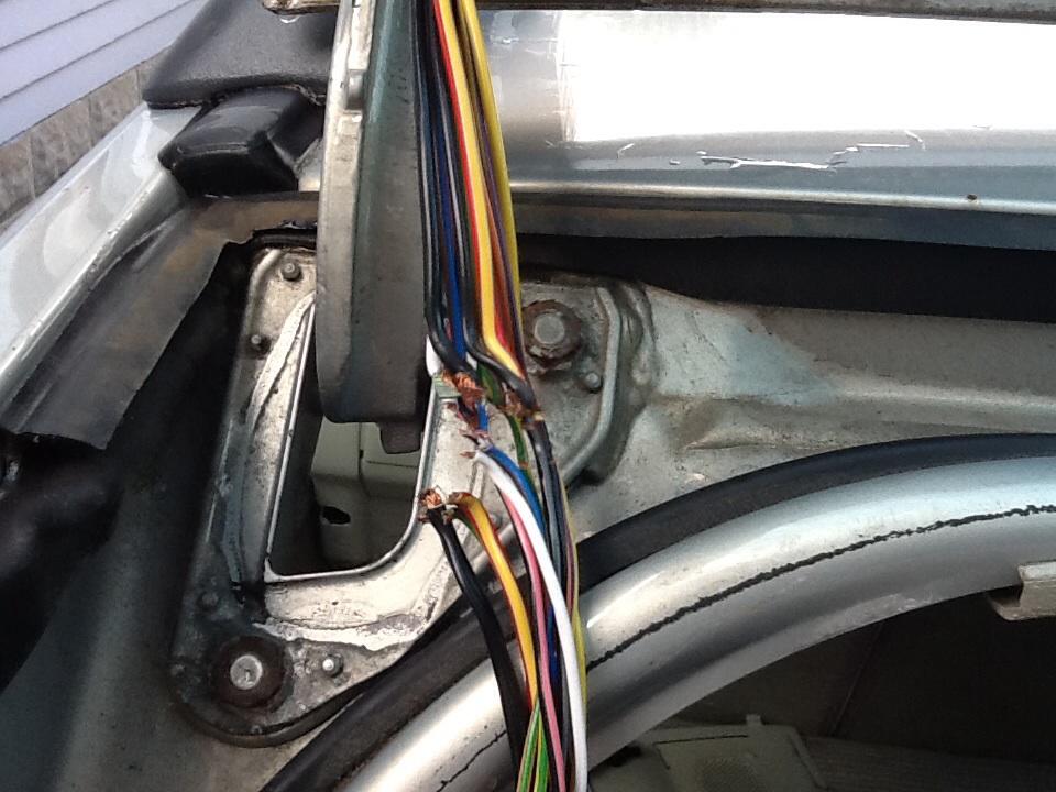

Here is a picture of what Mike is referring too. This issue seems to have popped a lot in the past few days.

Yep!
The best example of findings during a visual inspection...

Thanks alot I will go do that . Thanks for picture and for diagram site .. appreciate the help i will post up updates .

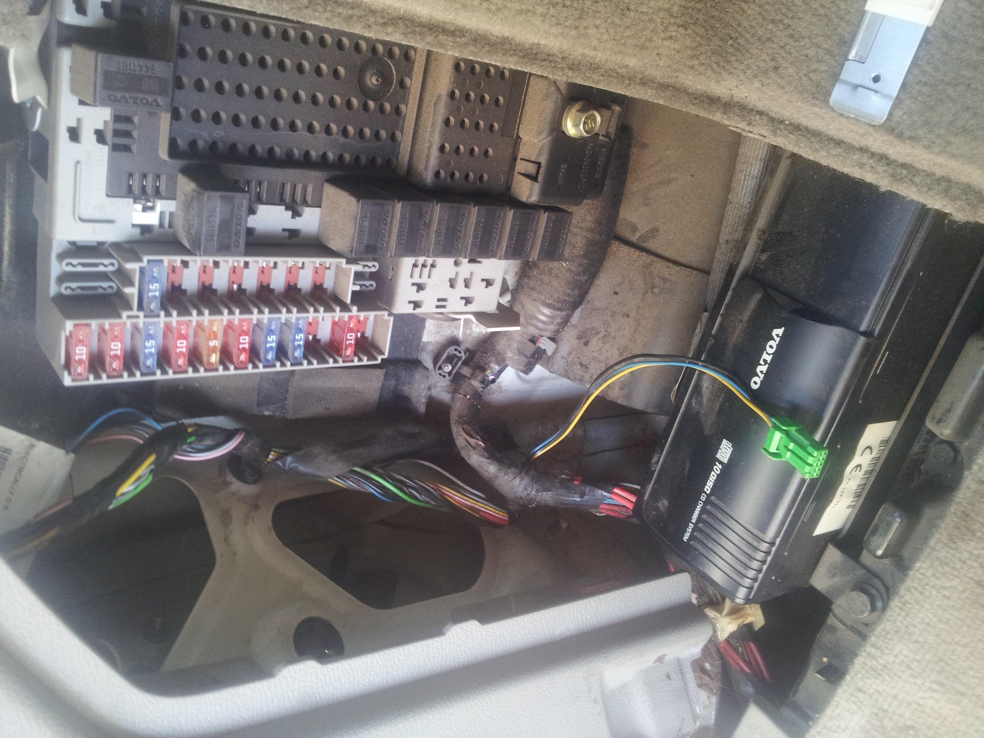

So I found this plug just hanging any ideas ..
Found this
Found this

Nothing to do with the plug, look at the tailgate harness as per the earlier picture - Mike
