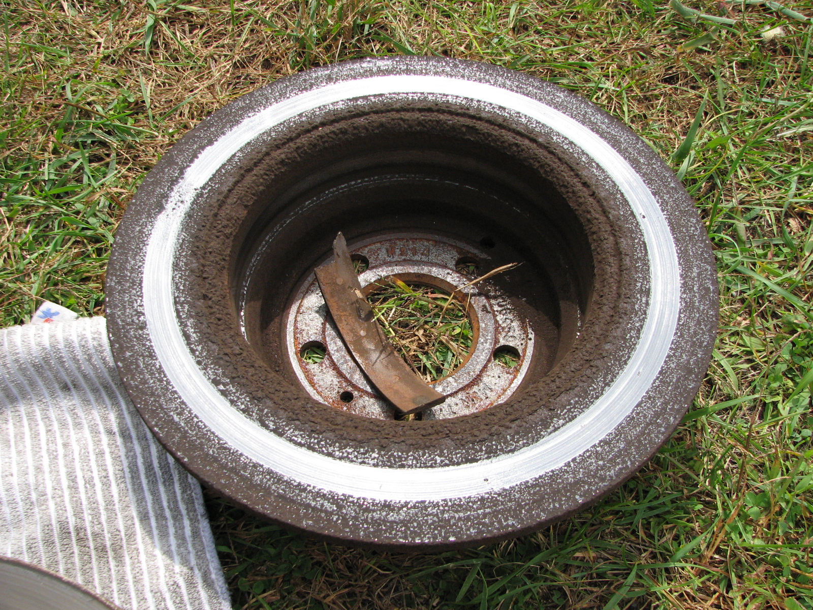

In saying the rear produces more dust than the front, what was the condition of your e-brake shoes the last time your rear rotors were off.
If you have never replaced the e-brake shoes, they tend to de-laminate and deteriorate back there after 15 to 20 years of age.
I have since replaced the e-brake shoes and springs on the '93 and '96. It is noticeably quieter back there with less dust on both cars.
Akebono ceramic with Brembo on the '93. Zinc coated ATE rotors with the same Akebono pads on the '96 Turbo Wagon.
Upon doing the rear rotors on the '93, The surface had come off one e-brake shoe. Having nothing to replace them with, I had to go without replacing the shoes. Being conscious not to use the brake lever until.
Both have new parts at this point. Yay.
Very little dust to report.
It will happen at this age, even if the shoes look ok at the last point of pad replacement.
This is an extreme example.
