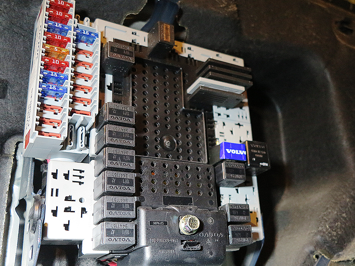

- remove RMI 06 fog light relay (it is working), set it aside.
- remove RMI 05 brake light relay, and install into RMI 06 fog light relay.
- switch on rear fog light -- If fog light comes on, then it's not brake light relay.
If it is bad...
There are three different part numbers, the one I posted is relevant by CH#.
Is that # correct?
The stack of relays at RMI 15 - 24 in photo show all are 9441161.

The original combo relay goes over RMI5 and RMI6 - brake and fog, respectively. Fog was working.
Unplugged the combo, and plugged a single at RMI5. Now rear brake light is back working, but not the rear fog. I will purchase a second single relay to restore RMI6.
Several positions do not have relays, like position MI3
Is there a way to find out if relays were there at first, but now are missing -- moved around to fulfill the need?

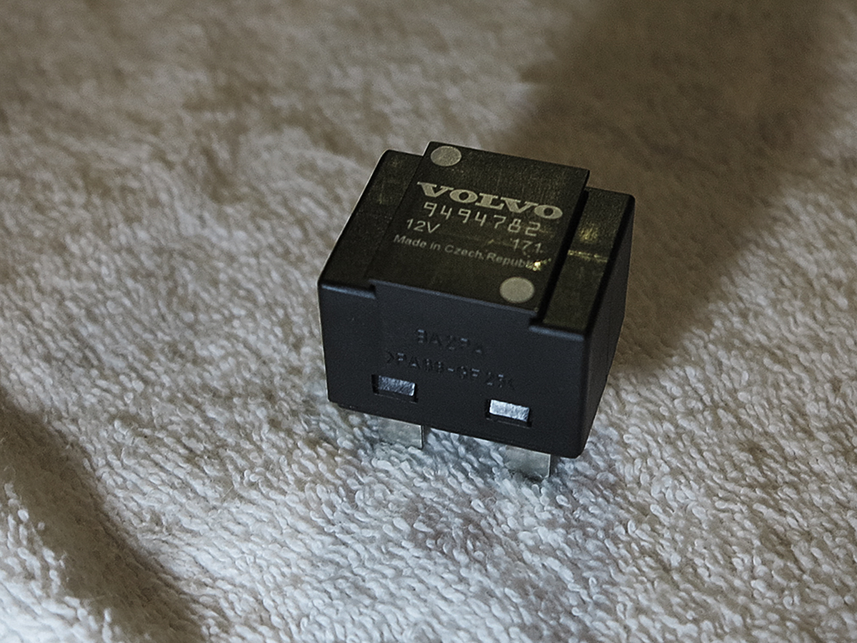

Two photos.
The Recall Campaign No. 131 - Brake Light Relay was intended to replace combo with two singles.
Should I ask for the two single from local Volvo at no cost?

Installed relay at MI5 is four pin.
The combo is a 5 pin relay at each MI5 and MI6.
Why two kind 4 vs 5 pin?
