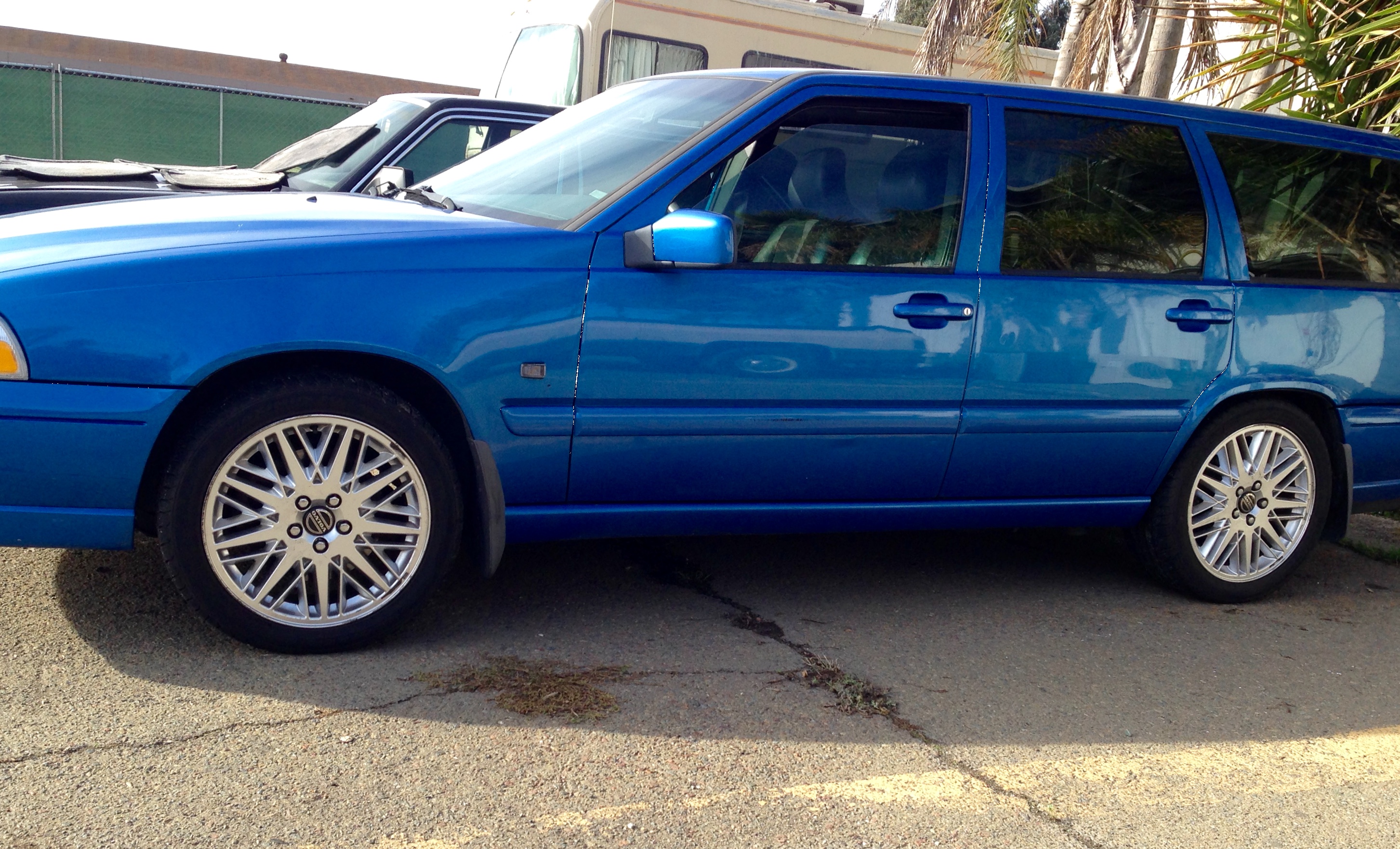

The rims I am running were very easy to find on craigslist for about $300US. But I do live in a very large (7million) metro area so its pretty easy to find everything... They are original Volvo Arakkis (spelling?) from an s80 and look great! Apparently some people have brake line clearance issues with s80 rims if they have upgraded to big brake kits, but I have not and do not. Just an FYI for anyone else dealing with rim issues reading this thread: the very common (and common at junkyards) s80 and s60 1999-2007 7x17 with 49mm offset rims with 65.1mm bore look great on v70 wagons and seem fit fine!
Paul, I think I'll just use used alloys with this same configuration for my snows now that I know they fit :)
I've attached a pic of 17" stock Volvo wheels on the v70 series. I think they look great and dont make you ride as rough as 18"s do. Thanks again to all.
