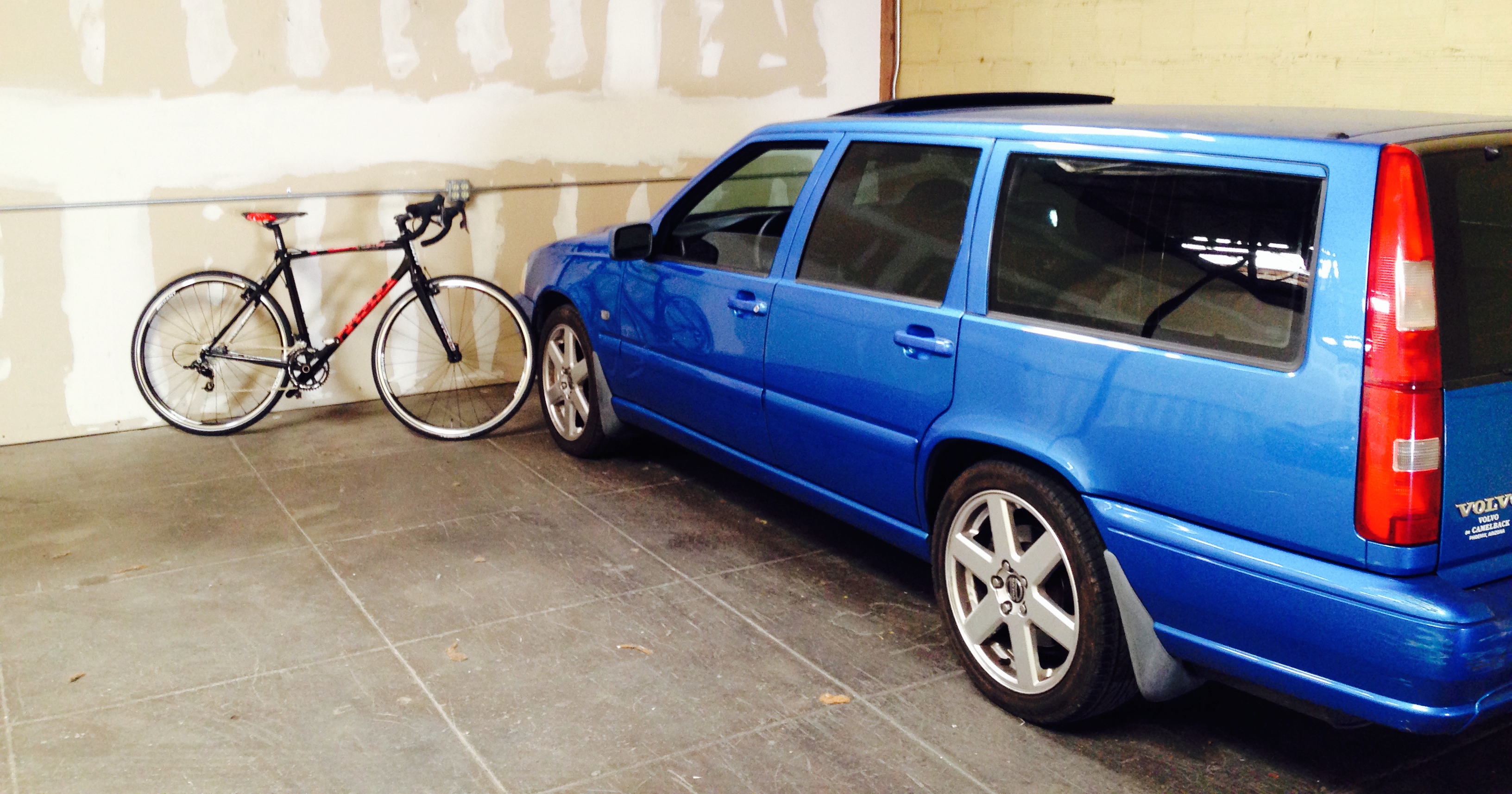

Hi guys. I'm experiencing major mechanical frustration with my beautiful 143k, 1999 Laser Blue v70R.
The car vibrates very badly, seemingly focused on the front right side. I bought the car one year ago with the intention of replacing everything needed and making it my daily driver/freeway racer. I "stage zero'd" it and after whacking it into a curb and ruining one of its wheels I began experiencing really annoying high speed (60-70 mph) vibration. The vibration is not necessarily under acceleration or deceleration loads, and does not happen during braking. I am not new to tinkering on cars... so to me it feels like a badly unbalanced tire... but I have done so many balancings along with the following at my local independent volvo mechanic to address the issue and it will NOT go away!
Here's whats been done so far:
-New 17" Borbet Volvo rims and new tires
- 2 standard wheel balance jobs from normal shops and "road force" advanced wheel balance
- professional laser alignment job
- both control arms and ball joints
- both front struts, strut bearings/strut mounts
- both wheel bearings
- replaced axles, twice and with different brands to ensure it wasn't a fit issue with non OEM parts, now running have brand new, not re-manufactured, set from FCPeuro
- tie rod ends, both inner and outer
- sway bar links
- front right motor mount- all other mounts appear fine (as did this one) but I replaced it anyway out of... frustration
- I also had my rotors spun have fresh brake pads in
- The car has a new to me, freshly lubed and finely-working angle gear and connector sleeve and AWD system passes the gravel test and does not vibrate or clunk when
So, naturally I am getting a bit frustrated, I love the car and don't mind having rebuilt the entire front end (as all of those parts would eventually have needed replacing anyway) but damn! I want it to ride smooth and powerful between 60mph and 100mph as it used to.
Anyway, the only thing vaguely related to rotation/vibration that I can think of have not replaced is the steering rack. Could this be it? The sub frame bushings? Angry norse gods? If not please help with other ideas.
Thank you

Beautiful car !!
I would replace the front brake rotors, there a cheap replacement, if that doesn't do it and considering you've done everything else its gotta be your steering rack.

Nice car! I have a 2000 laser blue V70R which I love also, but will soon be sold due to lack of use!
