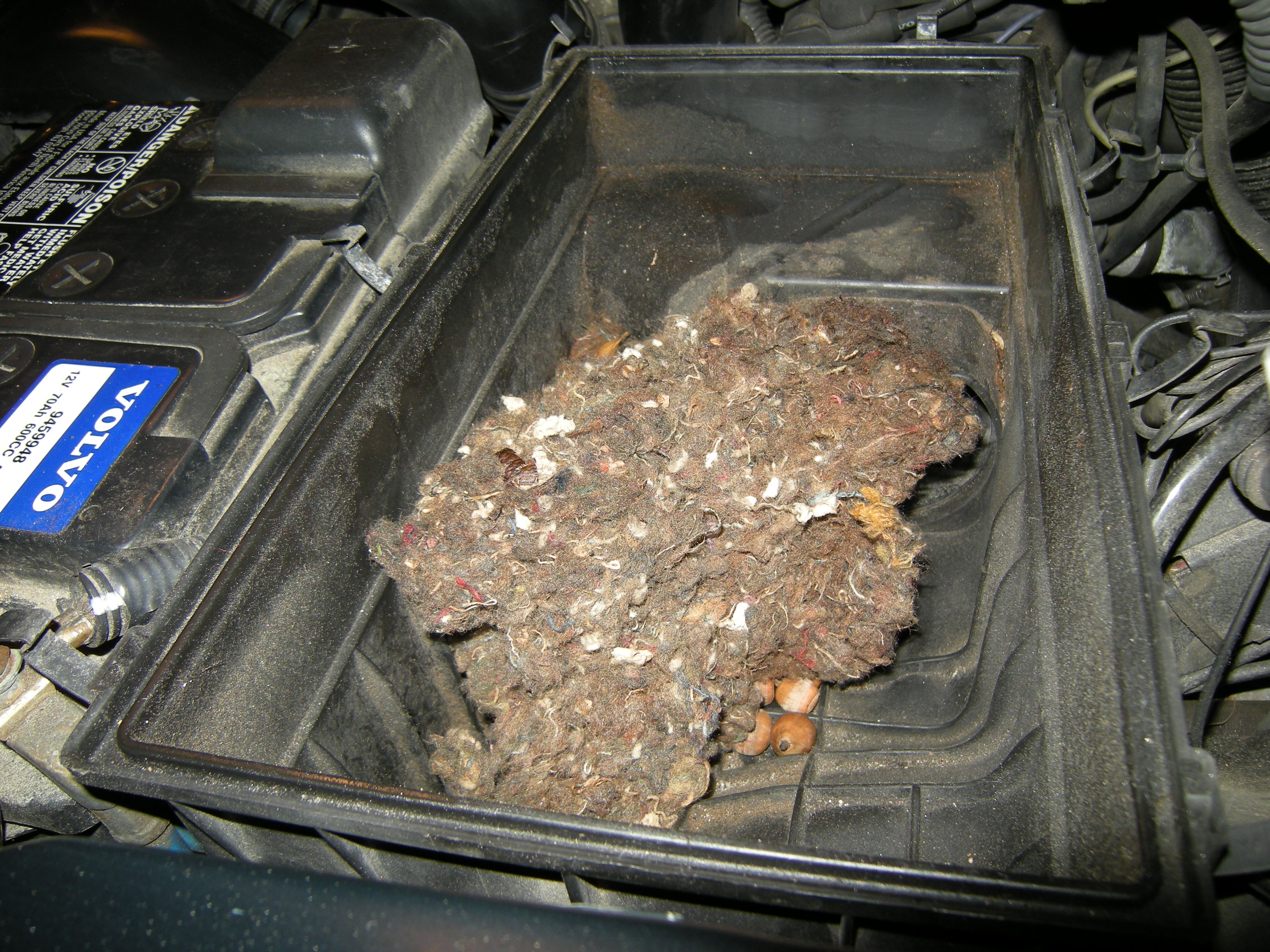

But seriously, if the car is stored outside, these little guys might make nests in unbelievable places. This is what happened when I parked my 850 for 3 weeks:
