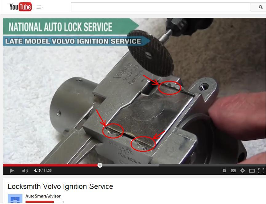

http://www.volvoforums.org.uk/showthread.php?t=171220
"I cut out the 3 peen spots with a Dremel with cutting disc and after a bit of levering with a screwdriver I detected a bit of movement, but the plate did not drop. Once the steel plate was loosened the ignition key turned to all 4 positions without resistance".
I am watching this video now in preparation for D-Day invasion lol. If this is true, I am so glad I don't have to remove the tumbler...all this is: remove bottom plastic cover (Torx), remove the rectangular plate and fish out all the bits and pieces that are already broken inside...
What this persons says makes sense (pay attention to time marking 4:15): basically dremel out only 3 areas of the rectangular plate. Stay tuned, I will report later if I didn't die from hypothermia lol...

You probably want to wait and hear from cn90 who has done both jobs but my impression is that removing the plate is much, much easier.

@speedyt5,
I feel for you, I spent $250 at 90K miles. I wish I didn't.
1- The kosher job (using your factory tumbler that you just bought) takes about 2-3h, mostly because of the shear bolts, heat, punch, hammer and all that jazz. This is the kosher way, see the link below:
https://www.matthewsvolvosite.com/forums ... hp?t=34472
2- Remove bottom plate, see the DIY I just posted last night. All you need is a dremel tool with diamond cutting wheel ($25-$30 @ hardware store) and some goggles for eye protection (actually very little debris came out when I used the fine diamond cutting blade). This job is very very easy, about 30 minutes total. It is easier than an oil change:
https://www.matthewsvolvosite.com/forums ... hp?t=67531
PS: The only function you lose when you do #2 is the loss of SW lock, a function that I don't care for.
If I were you, I'd do it the easy way (removing the rectangular plate), then:
1. Save the new tumbler as spare.
2. Sell it in classified section of forum or ebay for less.
