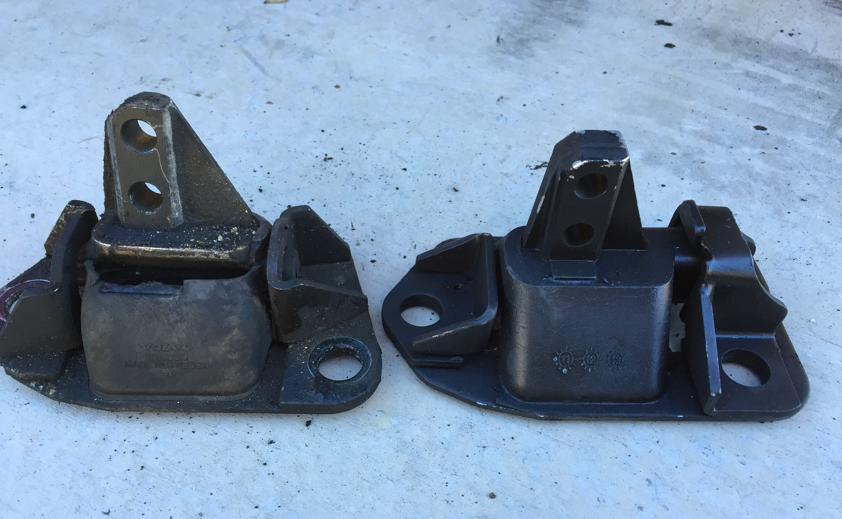

I had been told by the dealer that I needed an engine mount 2 years ago. I purchased a mount, but just never got around to putting it in. Last week, I did the timing belt and water pump change and saw the engine mount - which reminded me to dig out the old mount I bought all those years ago.
Here's the old and new mount. The mount was in fact completely broken and the engine was basically resting metal to metal.
BadEngine Mount.png (795.57 KiB) Viewed 914 times

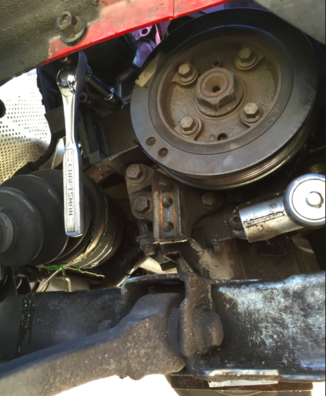

As it turns out, with the engine mount gone it made the timing belt access a little easier. So in the end all turned out well. Here's a picture with the mount gone while I was doing the timing belt/water pump. Those two holes below the crank on the left is where the engine mount bolts to the motor.
Engine Mount Gone.png (553.33 KiB) Viewed 914 times
I also noticed that the mount I got was URO. Are those any good? I know that they have a terrible reputation for their hoses, but I was wondering if the engine mount was any better.

You should have bought Meyle,Lemforder or Febi Bilstein.They are excellent aftermarket brands.
I don'think this one will last.
Uro,scantech....should be avoided for everything.
