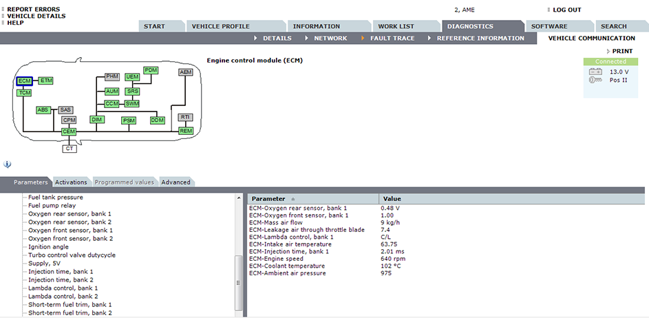

Meanwhile, per draser, here is one from 2/28 captured in garage while idling.

I can see the front o2 sensor, missed before, being in range of 2% of 1 lambda, so all good there as well. Don't believe there's anything wrong as far as mixture and conbustion of this engine.

draser wrote:I can see the front o2 sensor, missed before, being in range of 2% of 1 lambda, so all good there as well. Don't believe there's anything wrong as far as mixture and combustion of this engine.

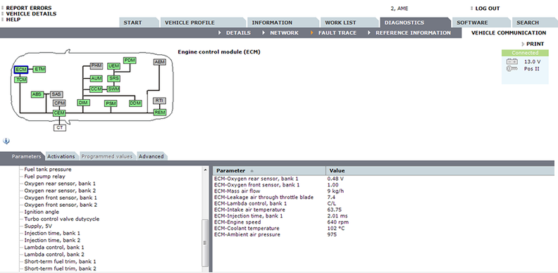

After a 35 minute drive home, some 16 miles on urban streets.
All modules are responsive with no DTC.
VC on VIDA
VC on VIDA
