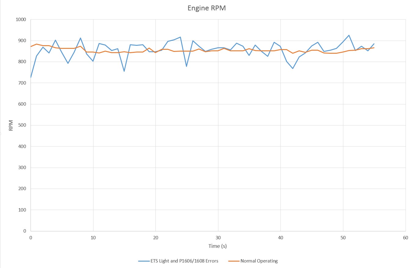

Today I was about to take the car for a test drive after changing the cooling system hoses and was logging with Torque pro app on my phone as I wanted to keep a close eye on the coolant temp just to be sure to be sure! Initially the car was hard to start but when it did the engine RPM was fluctuating quite a bit and running really rough, ETS light illuminated and P1606/P1608 codes. I let it run for about a minute as I was logging data. Then I switched it off and started again. This time it started straight away with no ETS light and no codes. I took it for a good run and it performed fine. It could have been a little more sluggish when hot (or it could have been my imagination!).
Anyway when I got back I plotted up the first minute or so when it started with an ETS and then the second time when it appeared to operate fine. These charts are attached. It clearly shows the engine RPM fluctuating in the first instance between 750-900 RPM and in the second start a LOT more consistent and smoother. Also the MAF does show a step change in the two as well with the first instance consistently higher than the 'normal' condition.
I'm not experienced enough to know whether these are linked. The codes I have read online are ETM and/or ECU related. Hoping some wiser heads may be able to offer some insight as the issue is so intermittent it is very unlikely my indy will be able to reproduce and I can't justify throwing money at possible fixes. So much I have already replaced I am hoping will eliminate quite a bit of the potential issues!
