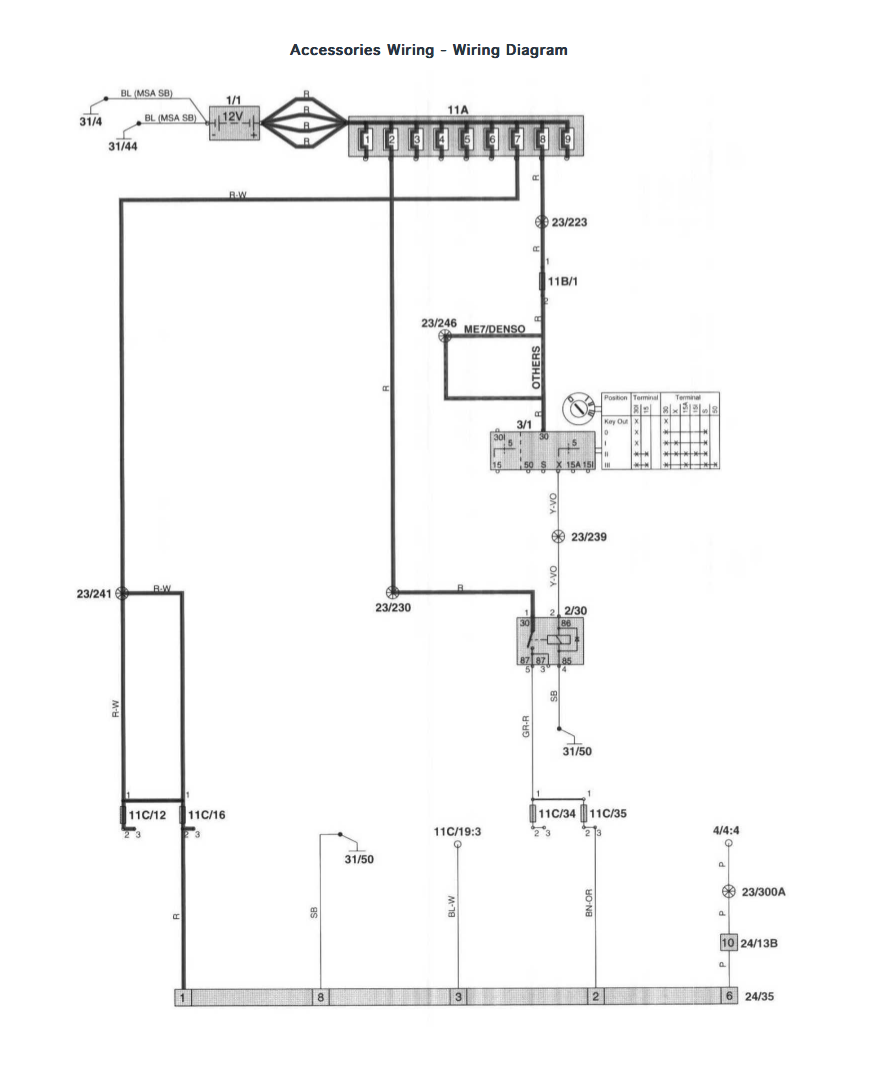

Im tapping into this for Abbys car and need some help
My B+ line is dead - Im wondering if I need to insert a fuse somewhere to light this one up?
Also - did anyone source the male pins for these so you can use the nice blank connector they give you already attached?
Project - rewiring the 12 VDC plugs to B+ rather than TERM 30 - so charging stuff works without key.
On edit….terminal 30 always hot, terminal 15 switched by key
Finally found reference for this puppy
Connector 24/35 in Alldata - Connector , 8 pin, Accessories
24/35
1 30-supply
2 X Supply
3 High beam
6 Rheostat, variable supply
8 Ground terminal
Yellow Accessory Plug Under Dash
Screen Shot 2019-05-02 at 9.03.28 PM.png (185.23 KiB) Viewed 1240 times

Have you chased power through Big fuse 7 and little fuse 16?
Those look like the only ones in the supply circuit.
As far as the pins, I think that Volvo uses the same style all
over the car. I suspect that you could grab a few populated
connectors at the JY, cut the leads long and release some
pigtails to retask for all of your accessory connector needs.
Please post back if they fit correctly. Good Parts Hunting!

Adding 2 cents a few years down as i ran into a similar project and wanted to post my solution. Photos of installation to follow.
I had a 300W inverter which i wanted to wire into the car, however i did not want to do it out of the cigarette ports as the plug would stick out. I had installed the map holder on the passenger side of my 98 v70 (had to throw away the knee bolster) and was planning on mounting the inverter under there. The goal was to get a high amperage fused line to the inverter as i also didnt want to blow fuses while charging a laptop, using a spotlight, or charging other equipment. Therefore, the plan was to tap the Red 30 Amp fused connector and switch it with a J relay rated for 40 amps. In my case the switching signal would be the brown orange wire which links to the ignition as it would turn on the inverter with the key. I know my brain and i would forget to turn off the inverter and be stuck with a dead battery so this was optimal. However, if you wanted to hook up running lights or something to that effect then the wiring would be the same, except you would run it out through the firewall and to the engine.
Diagram to follow once project is done.

You will be running 30-40 amps at rated load fir that inverter. That might exceed the wire capacity there, that’s really a lot of current.

Yes and i seriously doubt you could ever get 30 amps out of the cigar lighter port that's probably weyy over the rating for 30 amps.
A 300 watt inverter at 80 percent efficiency would draw 31.25 amps at 12 volts (engine off). For 30 amps the normal wire gauge would be 10 AWG but because it's such a short run you may get away with #12 AWG but check voltage at the input of the inverter at full load unless you plan to always use it at a lower output load like 100 watts or 200 watts, etc.

Yup, that was part of the reason i used the accessory connector for its 30 supply. I switch it through a relay with the brown orange so i dont forget it on. It all was wired up and works well!
