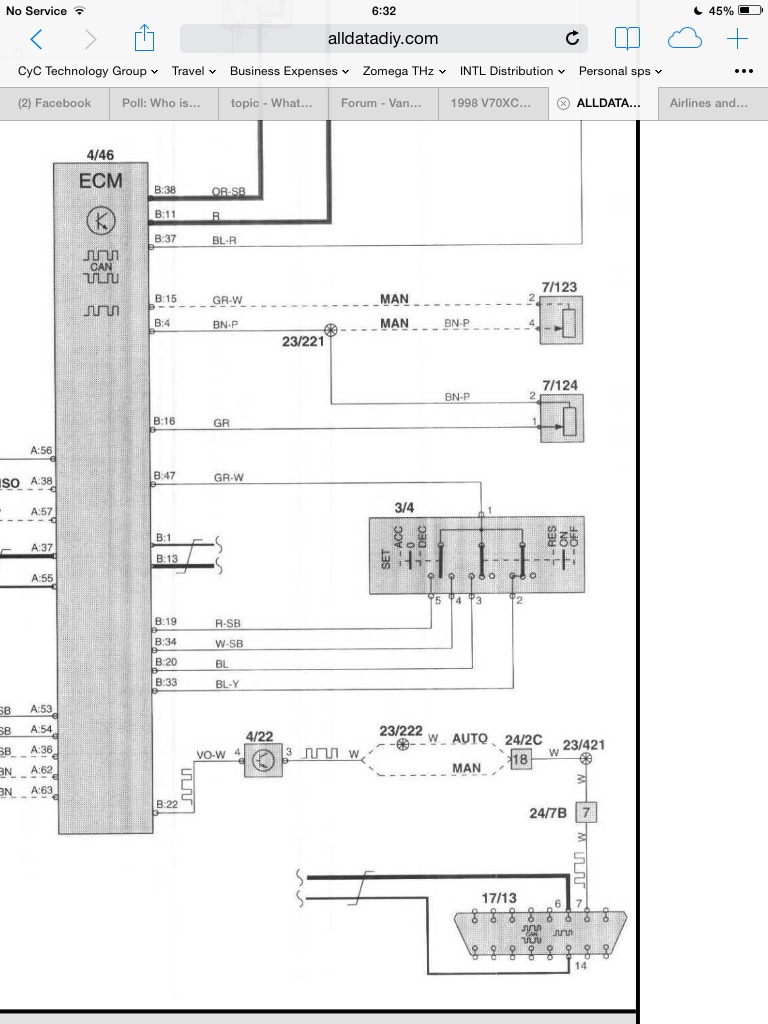

Here are your pin outs on the switch...it's component 3/4 on the diagram. Don't freak, electrical diagrams are a lot simpler than client discovery, it's just a new language...
When you move the engage switch, you should see both
Term 1 to term 2
Term 1 to term 3
Both go from open ( high resistance) to 0 ohm resistance as the switch is moved for OFF to CRuise. My guess is one of them, probably term1- term 2, will stay open or high resistance. Replace switch in this case.
Sidebar...the B47 input yo the switch is not a 12 VDC supply but a complex signal from the ECU. Don't put any voltage (including voltmeter on resistance scale ) on the ECU side of the connector. Testing in the switch side is Fine after you disconnect ( which you have to to access the terminals)
Term 1 to term 2
Term 1 to term 3
