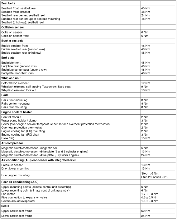

I looked up torques for my 2005 in Alldata and there was a funny one for the upper receiver/drier bolt
6NM, then loosen 90 degrees.
Pic attached.

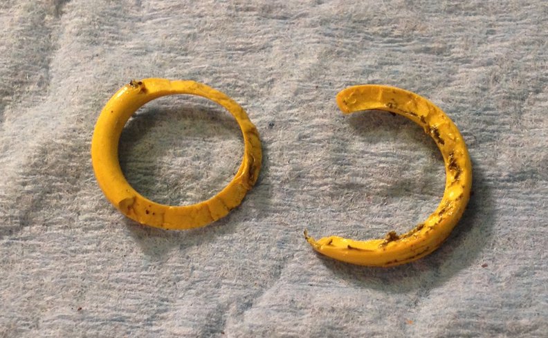

You will have to open up, install Oring, then get it pumped out and recharged.

Picked up the O ring from Volvo today and opened up the bolt this evening. The old one certainly had taken a hit when I originally loosened the bolt. The new ring fit well and the bolt tightened nicely. I recharged the system with a small 12oz can of 134a, but need to get more as it looks like the system should have a 35oz capacity. Hopefully, when the pressure is up to where it should be there will be no evidence of any leakage.
