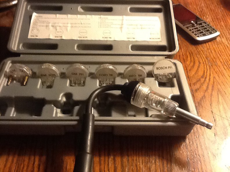

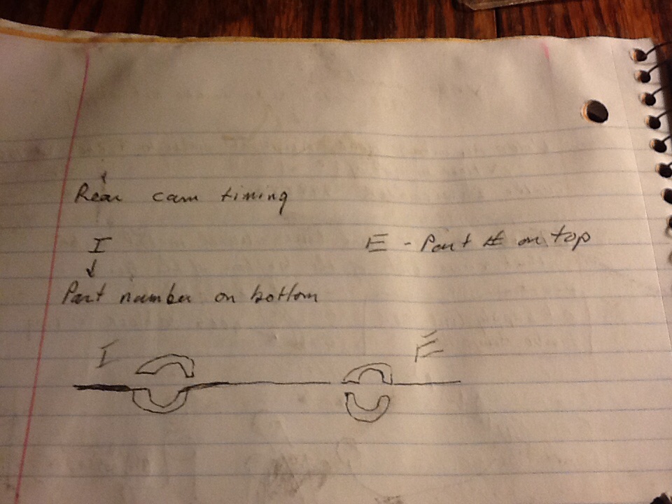

I have been in your position a few times and I always went to spark, compression and fuel. I have used a Noid light and lighted spark checker to see if they light close to each other. Another thing I got from one of Robert's videos was the proper orinentation of the cam shafts on the back of the engine. Using a wood dowl is #1 cylinder almost at TDC with the timing marks ? Have you shot starting fluid into the intake manifold? Is your distributor rotor at #1 spark plug lead when cylinder#1 is at TDC? I have also managed to incorrectly install my CPS incorrectly. You have to be close to firing this thing up.

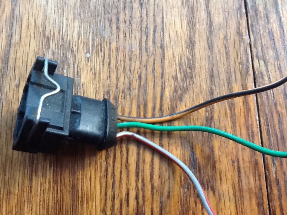

Any chance you have the TPS plugged into the Idle Control Valve and vice versa? I recall a post where someone said it was possible. Here is a picture of the Idle Control plug.
- image.jpg (278.74 KiB) Viewed 926 times
I have to say no to the switched harnesses , my TPS HA BRN\BLK, Y, ORG\WHT. Though my ICV has G, BLU\BLK, BLU\WHT. and I use colored zip ties on ALL small hose and harness connections as I disconnect them so I do t confuse them on reinstall.
But thank you for that suggestion. I will entertain ANY ideas.
