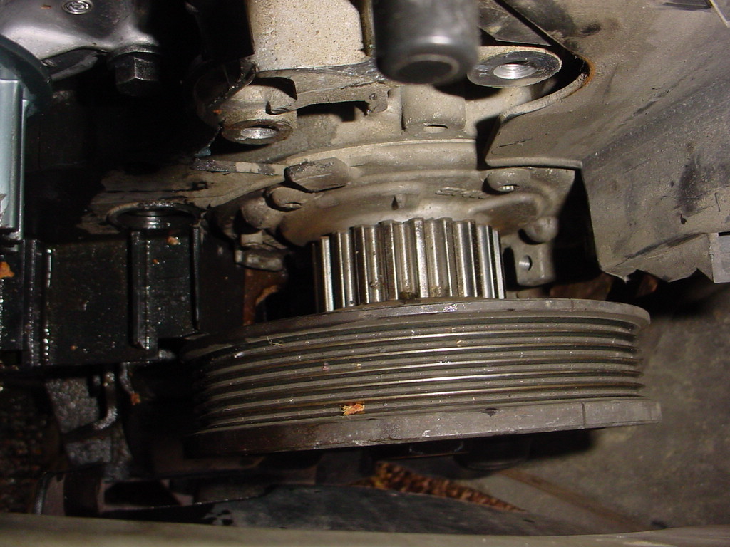

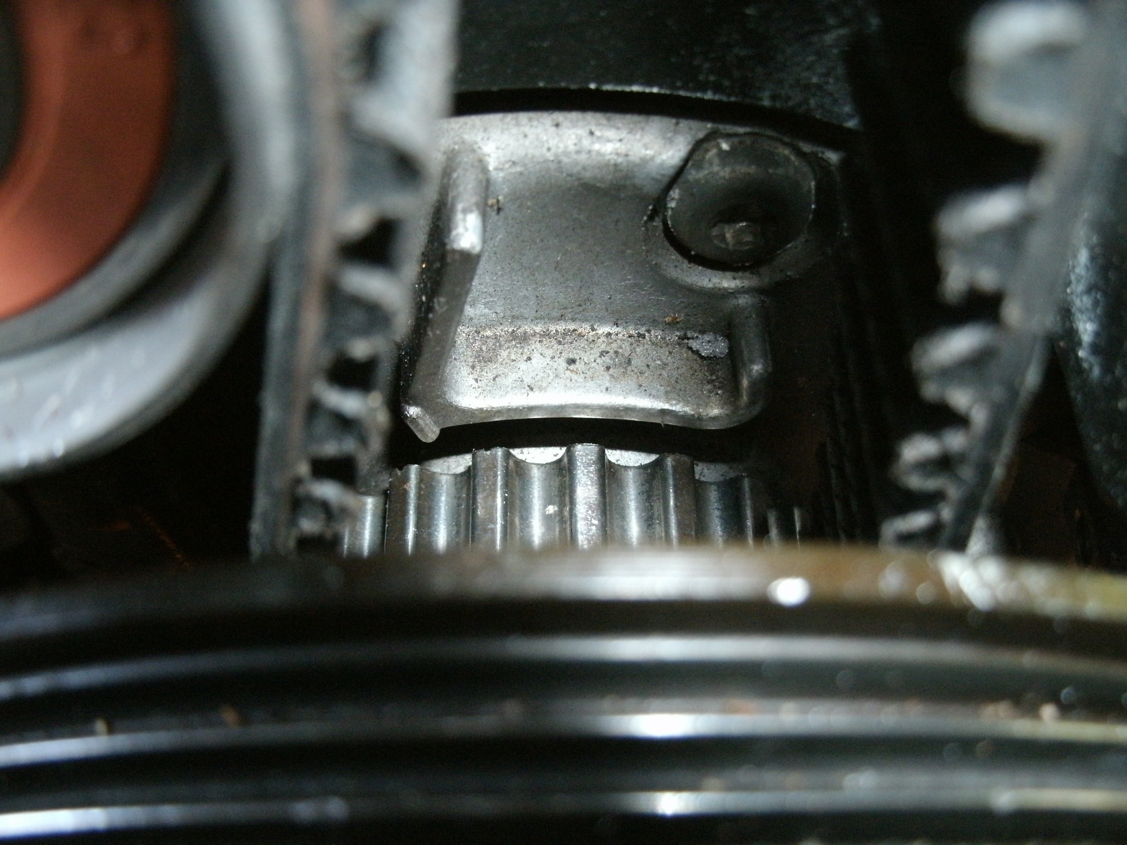

I set the timing with no cam gears from the back of the cam. And the crank timing gear mark with the oilpump mark. So i believe the timing is correct. My concern is the mark on the serpentine crank pully does not line up and that I possibly misunderstood which mark to use lining up the crank. Which would put the timing out about a 1\8 rotation.

I am not positive of proper timing at the crank. The timing belt pully and the serpentine belt pulley bith have marks on them . I used the mark on the timing belt pulley to line up with the mark on the oil pump.

The last vestige of hope is that i used the wrong timing mark at the crank. Should i have used the mark on the serpentine belt pulley or on the timing belt pulley

The mark on the crankshaft is very, very small and it is at the back of the sprocket. There are two versions of the mark. The single mark at the bottom of the valley in the sprocket and the two mark version that has two small notches on adjacent ridges.
This is the single notch version:
This is the two notch version:
In both cases the the mark on the oil pump lines up at the center of the valley, either at the mark or between the marks depending on which sprocket you have.
Any other marks on the serpentine belt pulley are meaningless with regard to timing.
...Lee
...Lee

It sounds like you got the timing marks right but maybe not, curious to know once you see the pics Lee posted.
