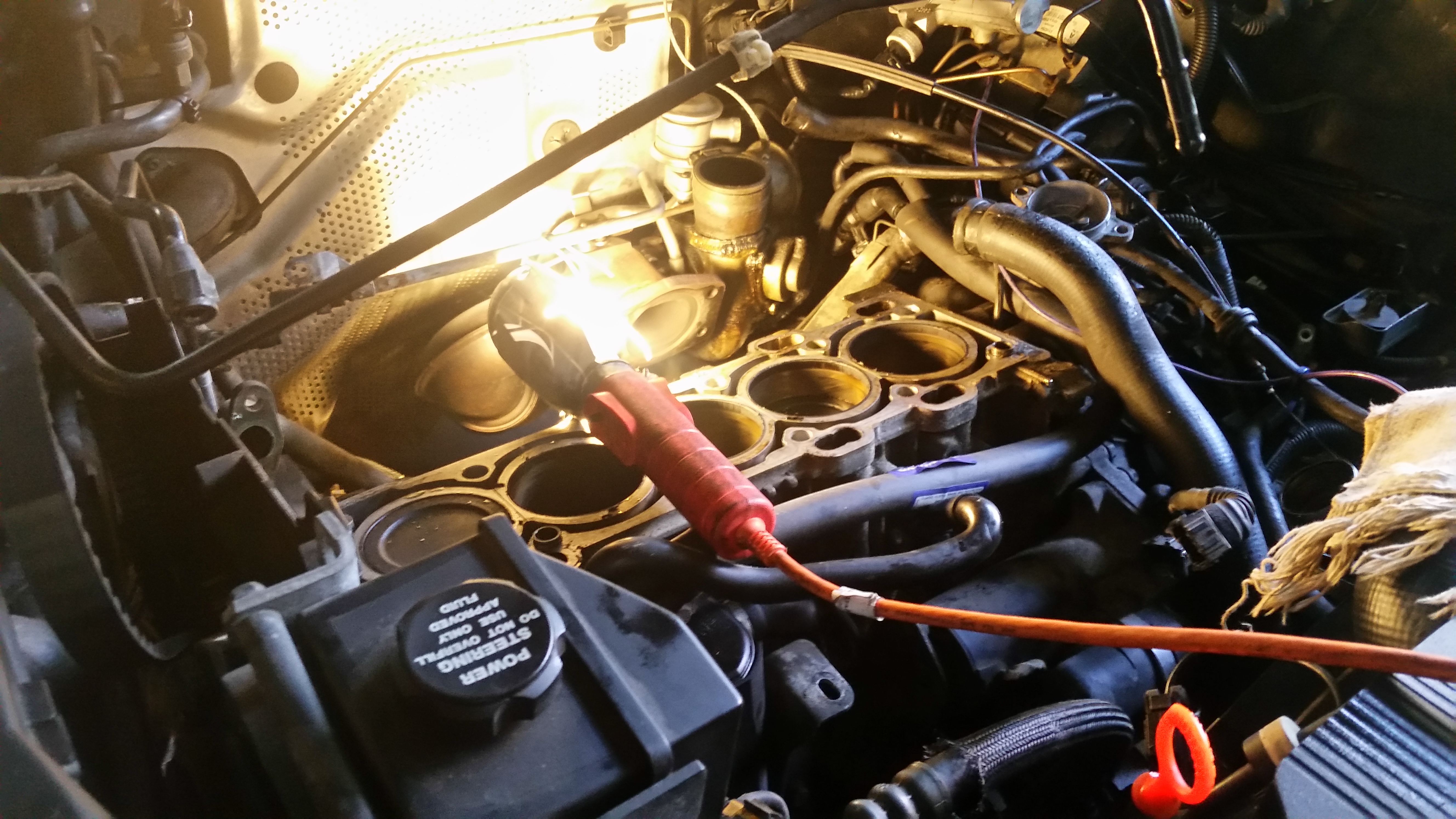

Well the car finally let loose and smokes all the time now. I have water mixed in the oil and a sweat smelling exhaust. So, a new head gasket is in order.

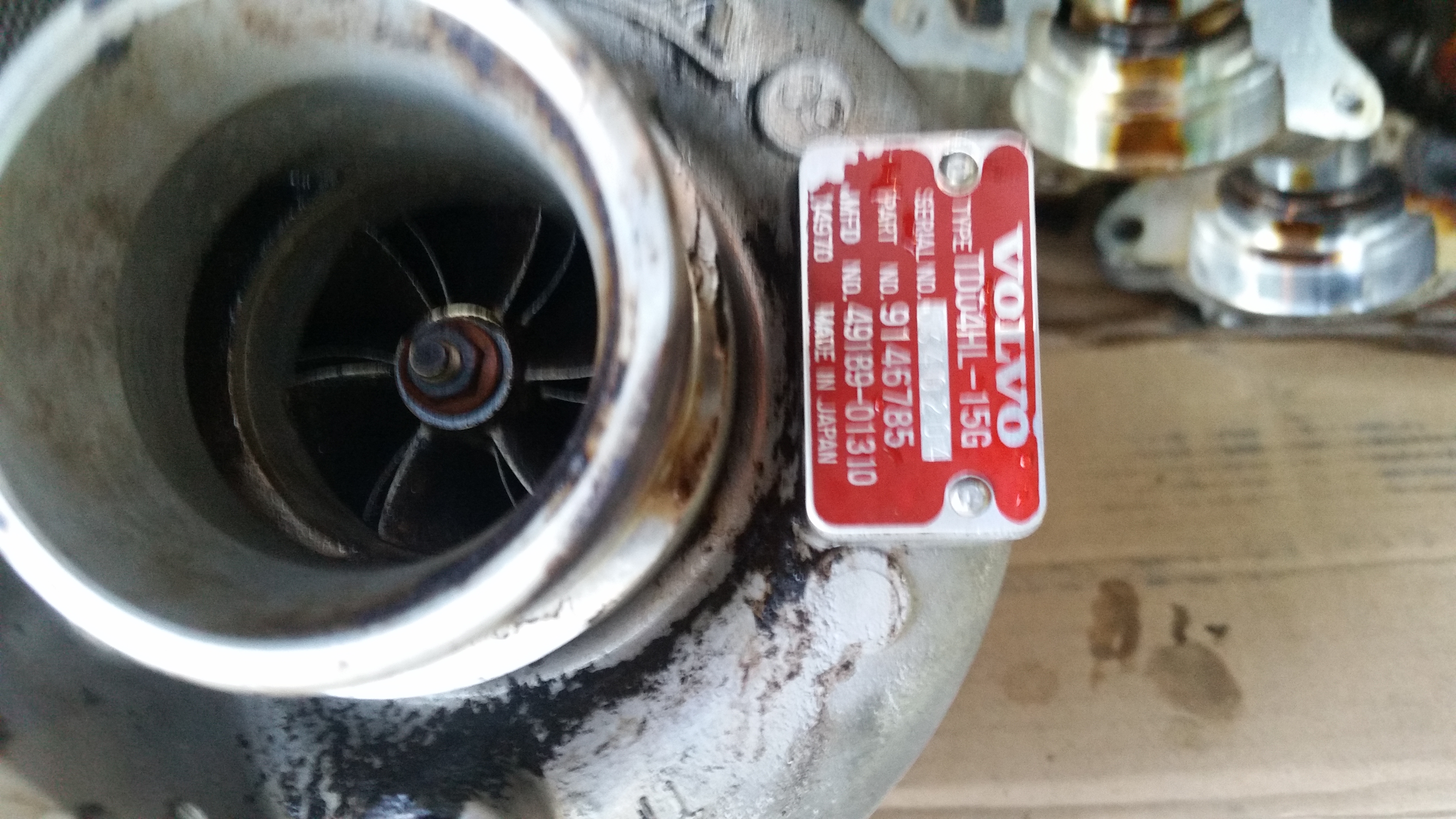

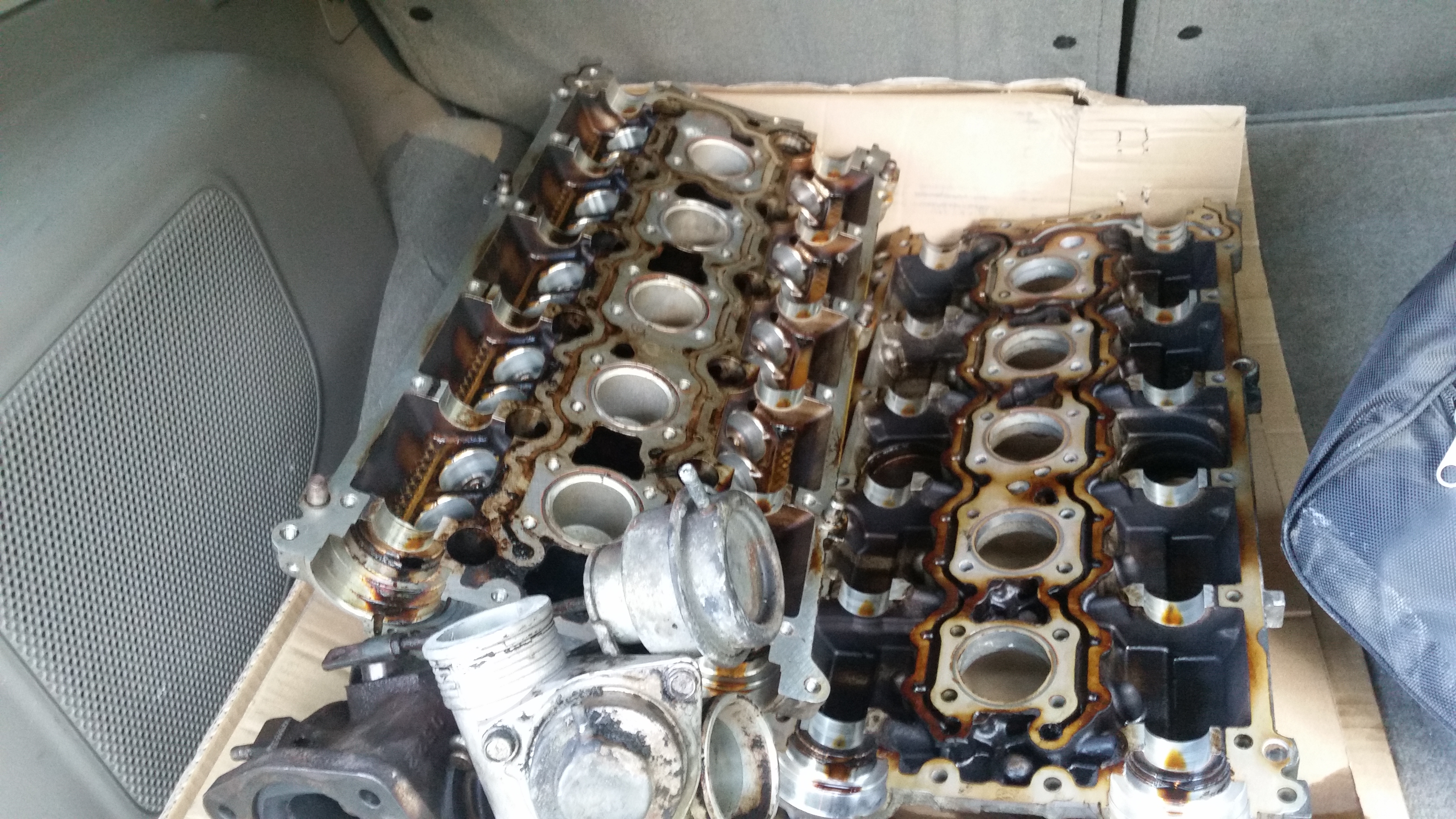

As you can see I have the car apart other than the 13g turbo out of the car. I'm getting ready to bring the head, the cam cover and the new 15g turbo to the machine shop. Yes I said 15g turbo :), I got it last night at the pull a part.
Now any help in getting this lpt car to run correctly with a 15g turbo will be greatly appreciated. The motor is a 2.4 liter stock with a 13g turbo. I want to mill some off the head, add the 15g turbo with manual boost control and a new boost gauge possibly with oil pressure and voltage.
I just couldn't help myself, I figured if I was going this far into the motor I might as well make it a little faster.
Motor disassemblied
Motor disassemblied
parts ready for the machine shop
My new turbo!
My new turbo!

The 15g will run fine as-is but in order to run with higher boost you would need to make a couple additional changes:
- T5 ECU
- higher flowing injectors from the same car as the ECU, to match the ECU
There are basically two ways to do this:
(1) Get an ECU from a 97 T5 850 and the orange injectors that came with it. This is the easiest.
(2) Get a 98 T5 tune flashed (programmed) onto any 95-98 ECU and get either the orange injectors or the white injectors from a 98 T5. If you do this, you must be careful to also flash the appropriate AC parameters so the climate control works properly. Don't just get a 98 ECU, the AC will not work and you will kill the climate control unit. You can also get rid of SAS during the flash, if the car currently has it. And down the road you can do things like increase the boost level at your option. Used ECUs are cheap these days.
There are detailed instructions out there for flashing an ECU, it looks complicated but it is not bad once you get into it http://m44.wikia.com/wiki/M44_Wiki. I am running m4.4 on my 95 with a 15g and oranges (its original injectors), and on my 98 GLT with a 15g and whites, they both work great. I'd be happy to help you with the ECU flashing, PM me if you decide to go that way.
