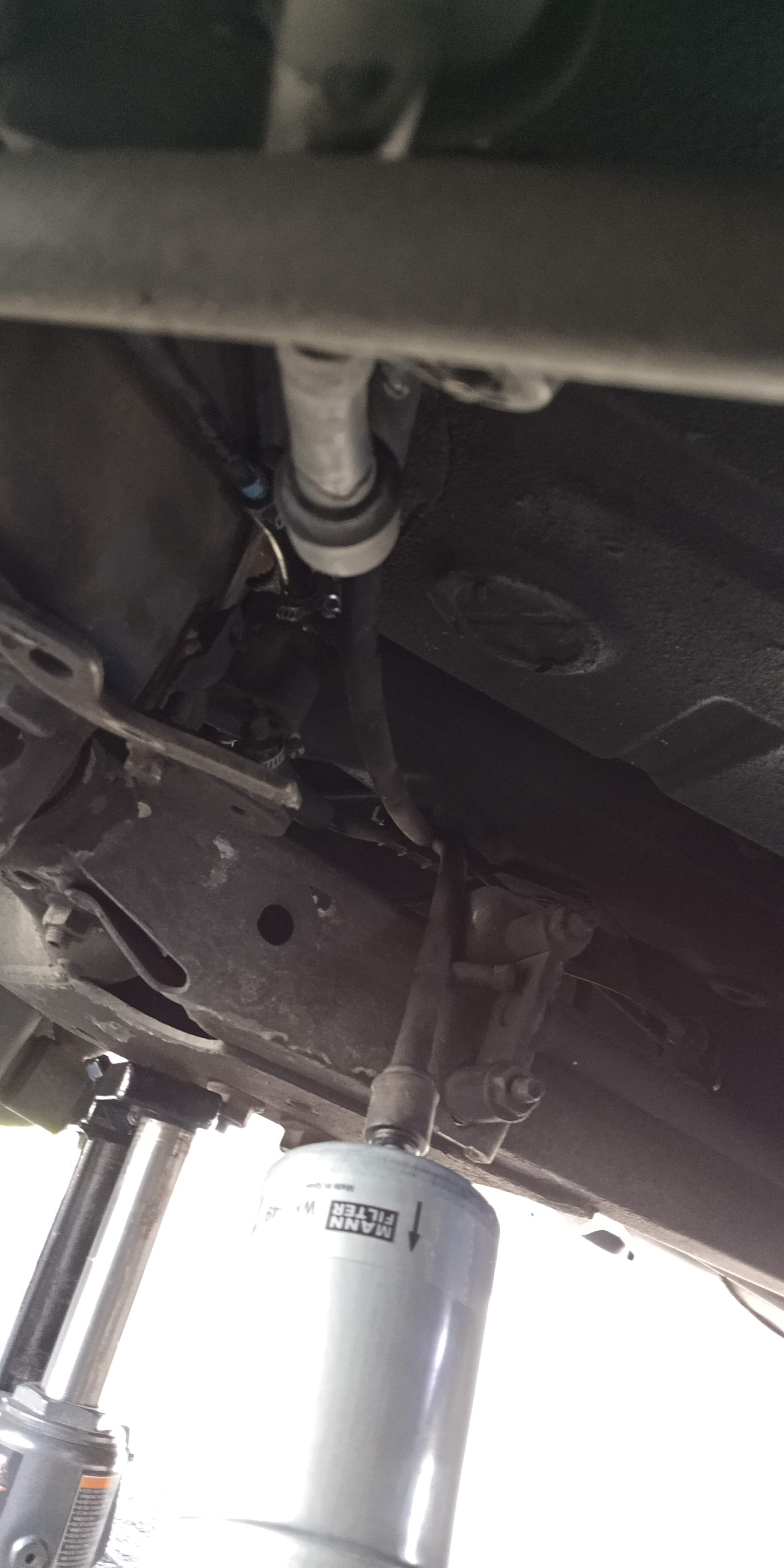

Here are some pics. I replaced the gas filter on my 1998 non-turbo V70 this morning and finally found that pesky little hose with different diameters at both ends. It was shot. I am hoping this is the only leak in my Evaporative Emissions System that was giving me the minor leak and then later gross leak error code (which I think is PO445). I replaced the hose (actually had one in my glove compartment waiting to figure out where it went). I will post a couple of pics from the passenger (USA) side in front of the rear tire. In these pics, the bracket that holds the fuel filter is not present. In one pic, you can see the fuel filter hanging down during the repair process. I don't think you can see or access this little hose with the fuel filter in place. I put hose clamps on this bugger, but they probably are not necessary, and I just barely snugged them down. The end of the hose facing the front of the car and the engine has a slightly larger diameter than the end of the hose facing the rear of the car.
